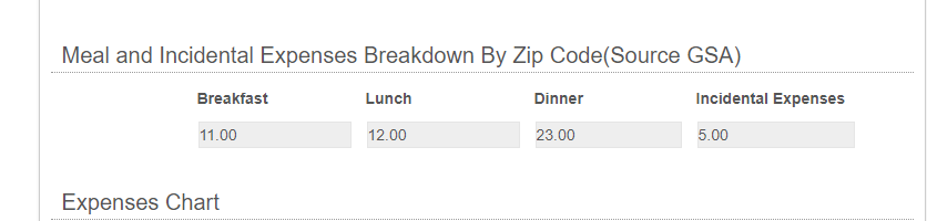

We are writing a form for finance, in the form there are two tables

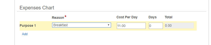

What we want to happen, is that if the user selects Breakfast, then ONLY the Cost Per Day BESIDE the Reason on THAT particular row is changed to match the breakfast numerical value from the Table above it.(As roughly shown in the demo above, except it needs to happen automatically).
(Both Tables in Preview Mode with Class Name). Right now the way I am handling it is, if it detects a change on tblReason, then it loops through ALL remCostPerDay and if it detects a "0.00 value", it changes it, see code below. And this method works, and it's functional, but there are limitations too it(Such as when the user changes their mind). We want it that to when it's changed, the remCostPerDay beside tblReason happens on each row and doesn't affect all other rows tied to that class.

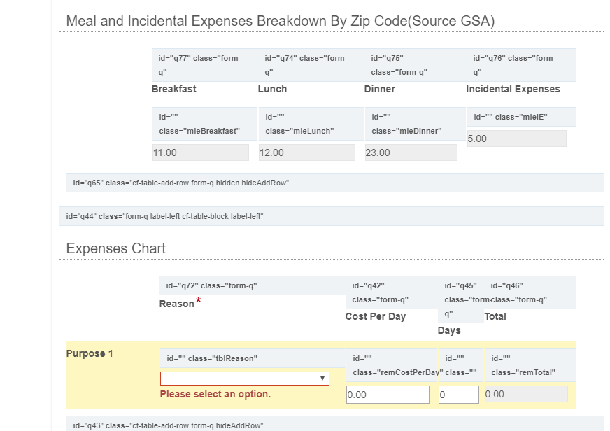

There are ways to use JavaScript to target a specific row, and if you examine the Field IDs you'll see that they have an additional number next to them indicating the Row.
For example Field1, Field2, and Field3 in a table would be like this:
#Field1(1)    #Field2(1)    #Field3(1)
#Field1(2)    #Field2(2)    #Field3(2)
#Field1(3)    #Field2(3)    #Field3(3)
So, in theory, you could do a few things. Find the common parent of the changed field first, then select only that parent's children, iterate through the rows based on the number - 1 to get the index, or just target the fields by ID and use the same number extracted from the changed field.

After seeing this and using Chrome Console, we were able to also come up with a Javascript/JQuery solution(In case anyone ever hits this roadblock and needs a JQuery alternative). Even though the equation way, in our opinion, is the better way to handle it and that is the method we went with. Here is the JQuery/Javascript below.
$('.cf-table-block').on('change','.tblReason select', function() {
  var reason = $(this).val();
  var breakfast = $('.mieBreakfast input').val();
  var lunch = $('.mieLunch input').val();
  var dinner = $('.mieDinner input').val();
  var reasonID = $(this).attr('id');
  reasonID = reasonID.replace("Field72", "Field42");
  document.getElementById(reasonID).value = "0.00";
  if(reason == "Breakfast"){
      document.getElementById(reasonID).value = breakfast;
  if(reason == "Lunch"){
      document.getElementById(reasonID).value = lunch;
  if(reason == "Dinner"){
      document.getElementById(reasonID).value = dinner;
Basically all we do in this code is grab the attribute ID of reason on a variable called reasonID, then we replace the Field72 with Field42(the ID of the Cost Per Day Row), then we use Javascript and set the value of reasonID to the variable we want(the class value from the first table). This way, on the switch, Field42(index) will always mirror Field72(index)
