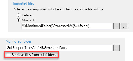

replied on June 24, 2019
I am having this exact same issue right now, but without any errors in the log. The file names aren't too long, and the ImportAgent Profile is not monitoring any sub-folders.
