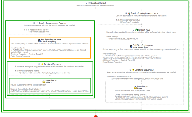

Why is this workflow's Conditional Parallel activity not moving on to the next branch?  I must have tried 20 combinations of configurations now and I am stumped!
The task is to create shortcuts in correspondence folders based on which choices the users made in the multi-value field called "Corr Filing Choice - To/From" but only if there isn't already a document there with the same name.
Track Tokens shows it is picking up the three values correctly.
Still, every test I run results in only the first value picked up from that field getting a resulting shortcut.  It should be creating three shortcuts in three different folders if the user chose three different values in this field.
In this second example, there were only two values in the field, which activated the second branch but still, it only created one shortcut; the first one it came across:

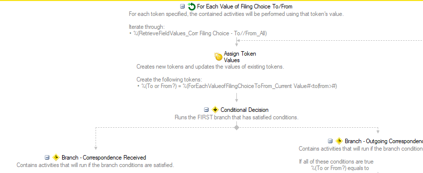

I have a For Each Value, so why is it not moving on to the next value after finishing with the first one?
replied on October 18, 2017

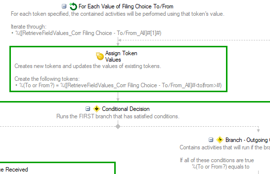

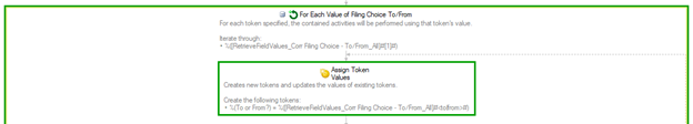

The image is small and I can't quite read it.  Can you show how your for each loop is set up?  It almost looks like you are only pulling the first value.  The image kind of looks like it ends in #(1)#.
My mistake, I totally missed that at the top of the screenshot.
It looks like token is set to only take the first index in the collection (the #(1)# at the end).
Remove that and you should be good to go.
In all of the configurations I tried, I did try some choices with the indexes and some of them showed the #(1)# in the configuration, however, nothing worked.
SUCCESS!  Thank you to both of you Jennifer and Jason!
It was the indexing option.  After posting the above, I noticed that I still had that on my latest attempts.  Once I change it back to no choices for the indexing, it worked!

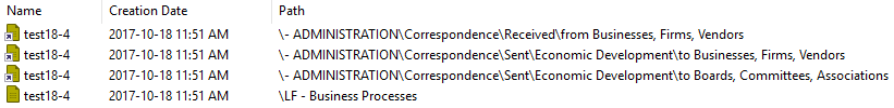

SUCCESS LOOKS LIKE THIS (Adding this for anyone else researching these posts for help with something they are doing):

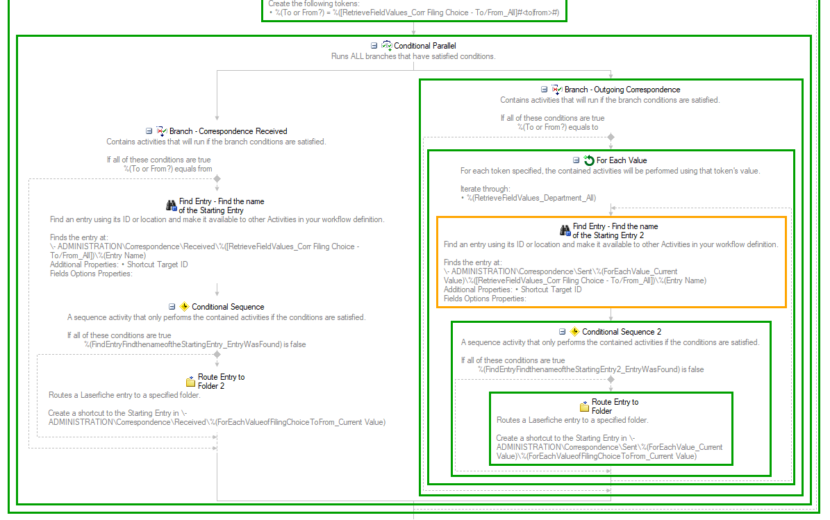

and the configuration to achieve that was:
replied on October 18, 2017 Show version history
You may be wondering why you see the department indicator in the path of the Sent correspondence.  It's because we separate out the Sent correspondence between departments, but don't bother doing that with Received correspondence.
