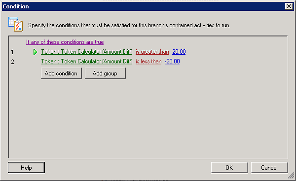

I have a WF that makes a calculation between an invoice amount and a GL amount. The problem is with the condition I have setup after the calculation. This is how I have it setup;

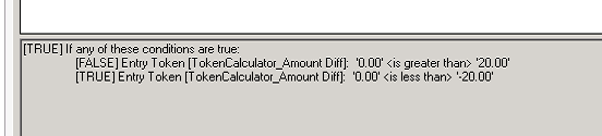

WF evaluated it like this;
As you can see, it thought 0.00 is less than -20.00. I'm sure there is something I'm missing to get it to understand negative numbers. Thanks for the help.

99.99% what Miruna said is what you're facing here.
If you left the token with the default "String" tag, then the evaluation doesn't view it as a number; in programming terms '0.00' < '-20.00' like you're sorting text.
However, if you apply the Number tag, then 0.00 > -20.00

replied on October 16, 2017
yep, defaulted to string. Changed the token tag to number and we are good to go. I was just reading about that so thank you for clarifying.
