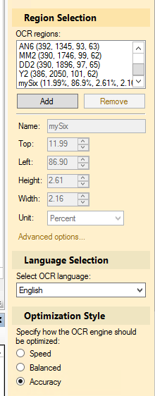

Hi, I have a stubborn six that just wont get picked up by Quick Fields. I'm new to Quick Fields so please bare with me.
I'm trying to use a rectangle with the "OminPage Zone OCR" feature. My settings are set to "Accuracy" and no matter how close or far from the inside of the borders I draw the rectangle, it just won't pick it up.

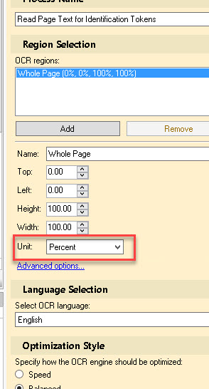

If you OCR everything around it, what does it think the 6 is?  Can you OCR a bigger area and post an image of the results so we know what quick fields thinks it is?
The other thing to look at is if your zone is set to pixel or percent.  If it is set to pixel it could be reading an area not even close to what you think it is reading.
replied on October 13, 2017 • Show version history
Thanks Jennifer,
I changed the "Unit" to "Percent" but I got the same result. The result is blank. See image attached.
Basically the six is inside that rectangle. I draw a rectangle inside that rectangle to only detect the six, but nada.

replied on October 18, 2017
I tired adding Despeckle, Smooth, Line Removal, but still get the same or worst results. Not sure if I'm applying them correctly though. See screenshot.
