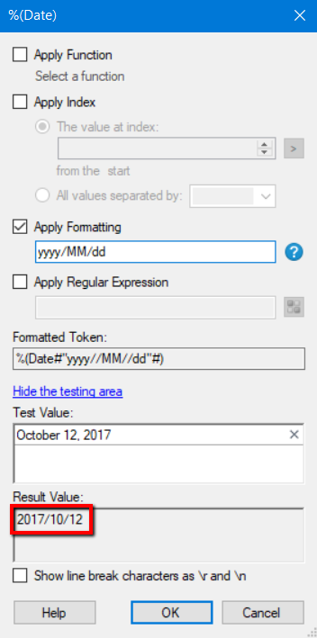

Try token formatting.

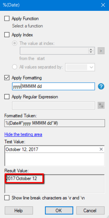

If your document name is "%(Document Type) - %(Date)" (e.g. "Invoice - 10/12/2017") and you want to reformat the date, then you can right-click on the Date token and click "Token Editor." This will bring up a dialog box for you to specify the date format you want.
yyyy: Year, 4 digits
MM: Month, 2 digits / MMMM: Month, alphabetic
dd: day, 2 digits
See more here.

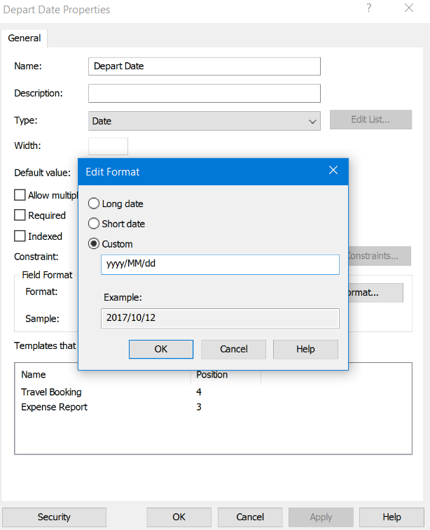

Is there a way to accomplish it using a date field? I have tried using custom and as it shows correct on the template field when it uses it as part of the name it puts it back in short date format
Misread your answer sorry about that
What does the format for your date field look like? Here's how I would create a custom date format in the admin console:
