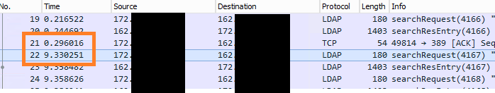

I wanted to see where the hold up is, so I setup a Wireshark to monitor the traffic going to and from the domain controller. There is a 9 second delay before the server sends the final auth requests to the domain, as if something is being processed. This explains the 9 second addition to login between a Windows Account and a repository user.
What is happening during these 9 seconds for the web users? Wouldn't the authentication requirements be the same regardless of which app they are logging in with?
172 is the LF Server, 162 is the Domain Controller

The fundamental difference between Windows authentication in Web Access and the desktop client is that on the desktop there is already a Windows session for the user, while in Web Access that session is created from the provided credentials at the time of authentication.  If for some reason there is a delay in this process, the Web Access user will experience it when logging in to Web Access, whereas the desktop user will experience it when logging in to their workstation - and that's assuming that the delay is not particular to one machine or the other.
All of that said, the network trace doesn't support the idea that there is a delay in that process.  As I read it, the packets on either side of the timespan are outgoing and don't imply that Web Access was waiting for a response.  On the other hand, the sequence numbers imply that Web Access isn't waiting for a network response from another service, like LFS.
