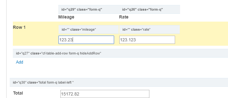

im looking to be able to enter a decimal number for rate & mileage.  Rate and mileage are form fields.
replied on October 5, 2017
When I enter the decimal in the form field I get the error "invalid input"  I am looking for a way to fix this issue.

Hi Ramika,
Are there any formatting restrictions on the field? Are you able to take some screenshots so I and others can better understand the issue?

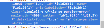

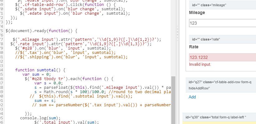

I have had another look at this as well for you. Maybe a better way to tackle this is changing the pattern LF is looking for. This should be available by adding the following:
  $('.mileage input').attr('pattern','\\d{1,9}?([.]\\d{1,2})?');
  $('.rate input').attr('pattern','\\d{1,9}?([.]\\d{1,3})?');
The idea here is that you can input any whole number that is up to 9 digits long with an optional following decimal number. The mileage pattern will limit it to 2 decimal places and rate to 3 as requested initially.
Replace both of the above with this instead and see how it goes. Sorry I hadn't thought of this earlier, I was just trying to disable the validation entirely.
I have attached my samples that I was working with for your reference.
Note: I have had to do my testing here on Single Line Fields and not Number fields. It might be easier for you to change the same within your setup if you haven't done already? That way you could just add the regular expression of \d{1,9}?([.]\d{1,2})? for mileage and \d{1,9}?([.]\d{1,3})? for rate and everything else should still work the same?

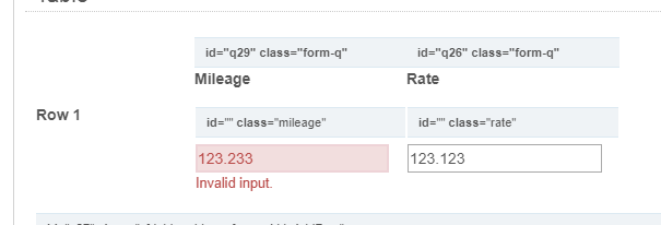

replied on October 17, 2017
Hi and thank you for the details... interesting, it works for 'rate' but still 'invalid input' for 'mileage'
