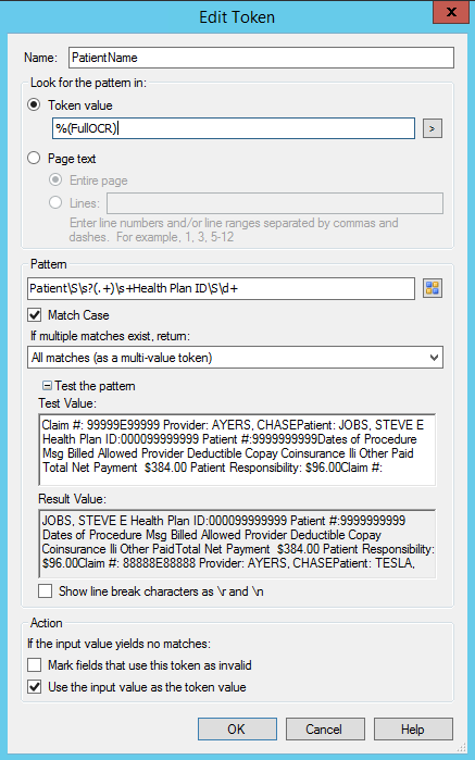

I have been having a lot of issues with Regular expressions not working with Quickfields lately.
Regular Expression:
Patient\S\s?(.+)\s+Health Plan ID\S\d+

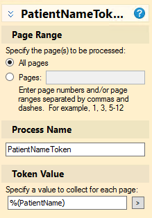

I am also trying to use Multi-Value Groups for these Patient names and it is not working as well.
I use the token accumulator and pass the values through but no success thus far.
Here is the Pattern Matching Token.
Here is the Token Accumulator for the Multi-Value Field "Patient Name"

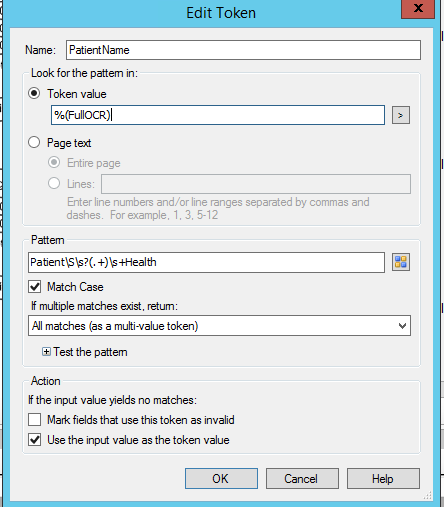

Testing REGEX:
Looks as though (.+) grabs all up to a certain point and ignored the Health Plan after.  I'm trying to grab anything between "Patient: " and " Health Plan"
Any help as to why the (.+) isn't working would be appreciated.

It appears that since you have multiple customers in the text it is pulling all the way to the last Health Care text.  In my testing it stops after Nikola.
replied on October 3, 2017
This works as designed since .+ matches everything between the first "Patient:" and the last "Health Plan ID". Try changing .+ to [^\n]]+ so it will stop at the end of the line when figuring out how much to match.
Amazing!  Yes I knew it had to be the ".+" since it grabs all essentially.  I wasn't sure how to stop it up to knew line and look at only the current line information.
Looks to be outputting my test example as I expected now.  I will play around more with the [^\n]+  Thank you!

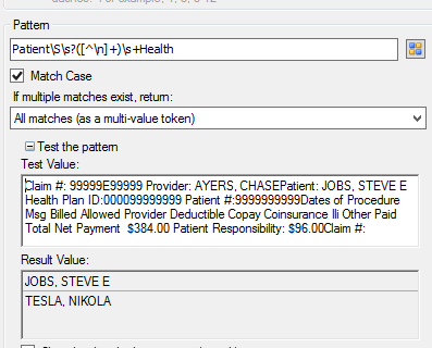

Output result I was expecting was:
Pattern Match:
JOBS, STEVE E
TEALS, NIKOLA
And the Multi-Value Field Group:
Patient Name - JOBS, STEVE E
Member ID - xxxxx
Patient Name - NIKOLA, TESLA
Member ID - xxxxx
