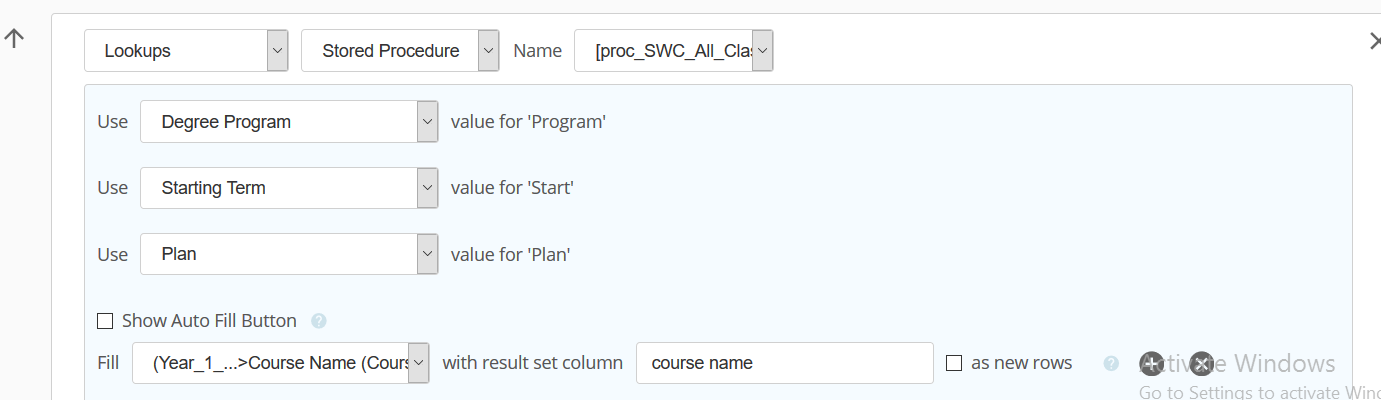

Second procedure: add the additional course's name to the dropdown (without adding new rows):

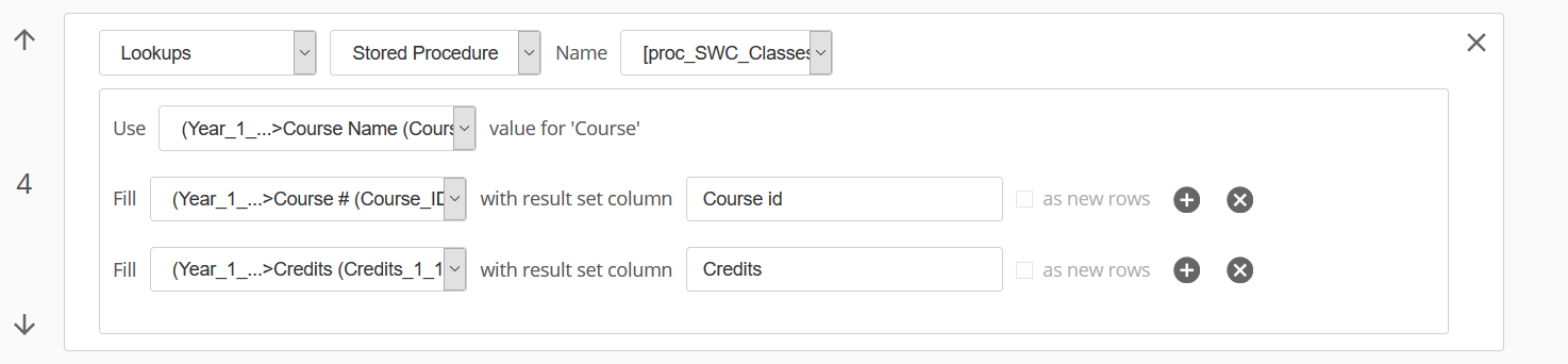

3 procedure: Lookup when the course name changed (this is the one not working):

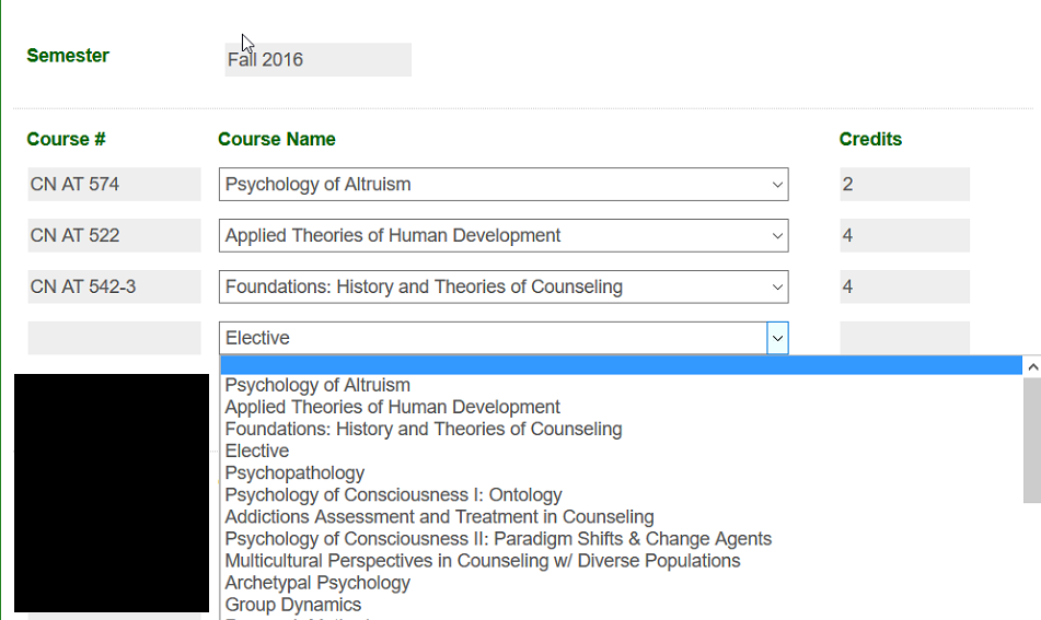

Screenshot: in this sample, only 4 classes returned from the 1st procedure, then the 2nd procedure filled all the available classes. When the user changes the course, the 3rd procedure should complete the course id and the credits.  Any help will be appreciated!!

Looks like you might have conflicting lookups. Both the first and third lookup rules act on the Course # and Credits fields, so they would conflict with one another and the first would likely override the last one.
Try removing those from the first lookup rule. The third rule should populate the values in response to the first lookup rule anyway, not just when the user changes something.
replied on October 3, 2017
Hi Jason,
You were correct, I removed the Course # and Credits and the 3 procedure update those fields on initial load and also after any change.
