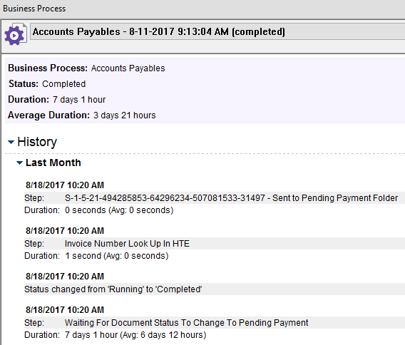

What is the best way to export the business process history from an entry? This is the data stored on the Business Process tab in the entry:
Thanks!
Thanks!
