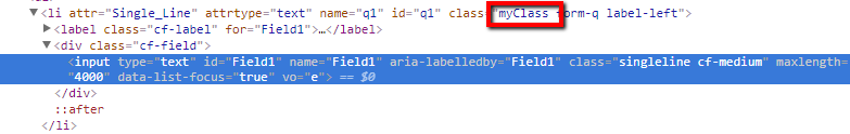

In my function, when specifying to work with each input field by class name, then return the class name, I get a different set of class names then the ones I have assigned.
It's strange that I can reference the field by a class name in the for each statement, but when I ask it to tell me it's class, it doesn't even return the class name that I used to find the field to begin with.
The reason I need to know it's class, is so that I can know which field I am on, as there is an unknown number of them on the form preventing me from referencing by iteration. Although the fields share the myClass (which I just used as an example) they also have unique class names.
This works with tables, but not with input fields.
$('.myClass input').each(function () {
       var str = $(this).attr('class');
       alert(str);
Here is what it returns: singleline cf-small lf-no-validate
None of which include my custom classes that I have assigned.

The element find by $('.myClass input') is the input element which does not contain the custom CSS, while the custom CSS is applied to the li element:
The blank space in '.myClass input' means finding the descendant input element of an element with class 'myClass', see https://api.jquery.com/descendant-selector/
To find the li element from the input element, use var str = $(this).closest('li').attr('class');
Note that there is no li element for fields inside table so to find class for field in table, use var str = $(this).closest('td').attr('class');

Thank you very much, also explains the " input" and " select" requirement. I always thought it was just an extra requirement to verify what type of field your working with. I have been thinking of each field we drop on the form as a single object.
