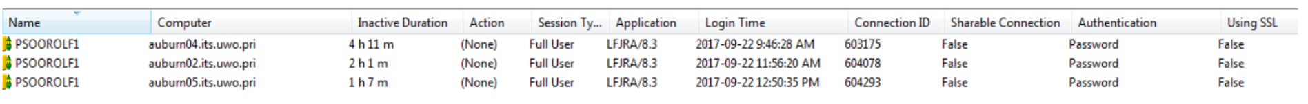

Below I have a picture of the local userids in the LF Admin Console that are connecting using the Laserfiche SDK Java.
We have the  LF Admin Console repository option set to time out sessions at 200 mins.
It seems that timeout option does not apply to the LFJRA/8.3 users sessions.
1. Is there another system setting that we can change that would timeout the LFJRA/8.3 users sessions?
2. Otherwise, is there a script that you can give us to run that would timeout the LFJRA/8.3 users sessions?
Thanks
Brian
