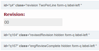

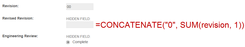

I have the following fields:
When Engineering Review is on, the Revised Revision field needs to be applied to the Revision field (and stick):
$(document).ready(function(){
//Set revised value for Revision field
  if ($('#Field167-0').is(':checked')) //If engReviewComplete radio box is on
    $('.revision input').val($('.revisedRevision input').val()).change(); //Set Revision field to revisedRevision value
});  //close document.ready
But it's not! When this task goes to the next person, it still shows as Rev. 00 when it should show as Rev. 01. What am I doing wrong?

replied on September 21, 2017
What I have is working. It does fill in the Revision field with the updated Revision level. The problem is that the value is not retained when it moves on to the next person.
Are any of the fields involved read-only?
replied on September 21, 2017 • Show version history
Wait ... the Revision field is read only! I know where you are going with this. I'll get back to you!
