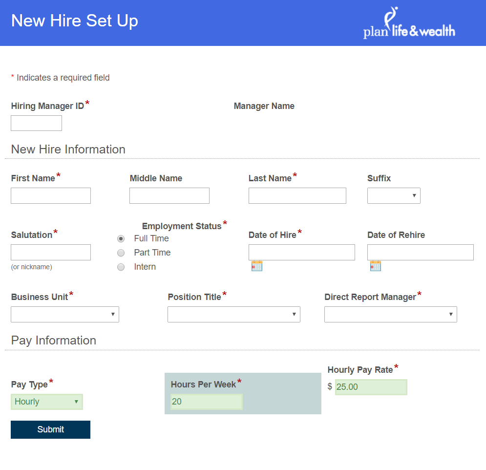

asked on September 18, 2017
I'm creating a New Hire Set Up Form that includes a radio button field, Employment Status, with three choices:  Full Time, Part Time, and Intern.  If Full Time choice is selected, the Hours Per Week field must be at least 30, but not greater than 40.  If either the Part Time or the Intern choice is selected, the Hours Per Week field must be between 1 and 29.
Can this be accomplished with javascript? Or, is there is a better way to validate the Hours Per Week field?  If not, a sample script would greatly be appreciated.  Thanks!

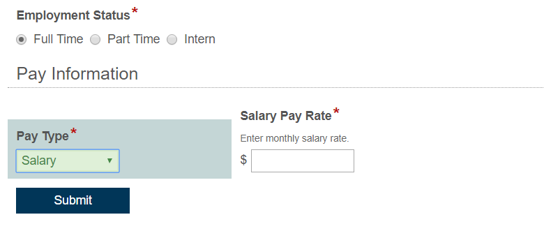

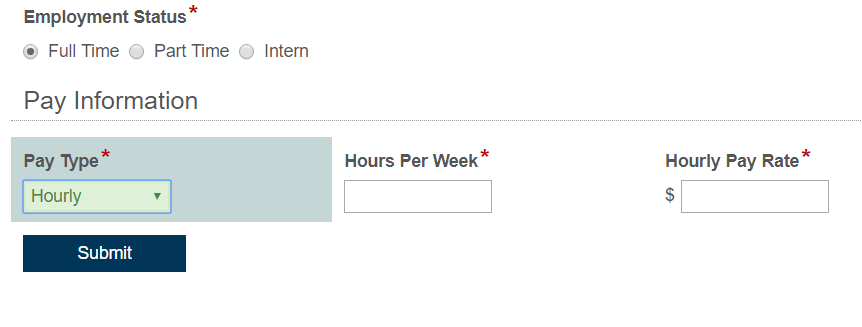

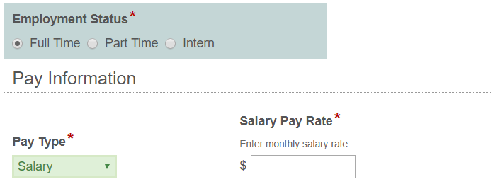

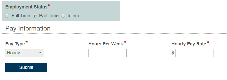

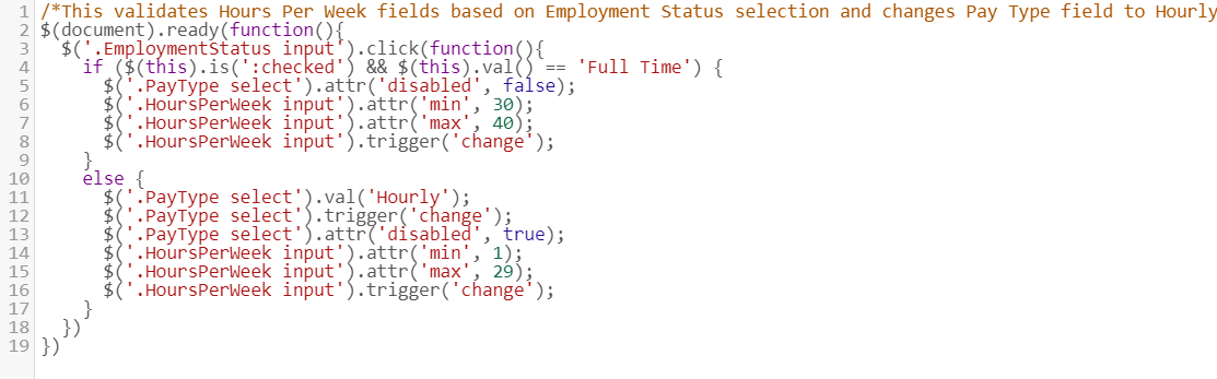

replied on September 20, 2017
Rui,  works great!  Here's the complete script, as recommended, and printscreens of the Employment Status and Pay Type field selections.
Thanks for all your assistance!
John and Rui, thanks for sharing this particular example.  I have another use case where I can use similar scripting, so this was great!
replied on September 18, 2017
Hi John,
It can be done with javascript like this (add CSS class employmentStatus to Employment Status field, and add CSS class hoursPerWeek to Hours Per Week field):
$(document).ready(function(){
  $('.employmentStatus input').click(function(){
    if ($(this).is(':checked') && $(this).val() == 'Full Time') {
      $('.hoursPerWeek input').attr('min', 30);
      $('.hoursPerWeek input').attr('max', 40);
      $('.hoursPerWeek input').trigger('change');
    else {
      $('.hoursPerWeek input').attr('min', 1);
      $('.hoursPerWeek input').attr('max', 29);

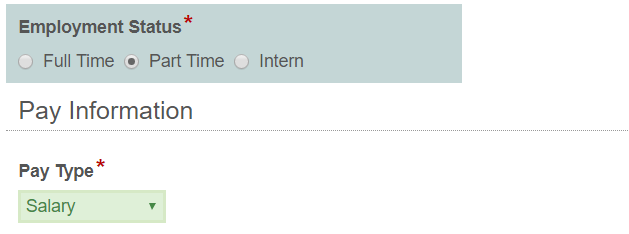

replied on September 19, 2017
Rui, to continue to build on this scenario, a Salary Pay Type is available only for Full Time Employment Status.  As you can see from the image below, when the Salary Pay Type is selected, the Hours Per Week and the Hourly Pay Rate fields are hidden using Field Rules and a Salary Pay Rate is shown.
If the Part Time or the Intern Employment Status radio button is selected, is there additional script that would automatically change the Pay Type drop-down choice to Hourly? (which the Field Rules will then show the Hours Per Week and the Hourly Pay Rate fields and hide the Salary Pay Rate field)
As always, Rui, your expertise is greatly appreciated!
