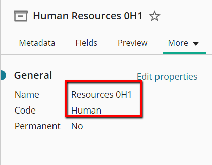

Well, it turns out if you rename the record series in the Web Client, it replaces the code with the first word of your new record series name. (We're looking into this behavior.)
This makes for an interesting work-around but likely not what you're looking for.

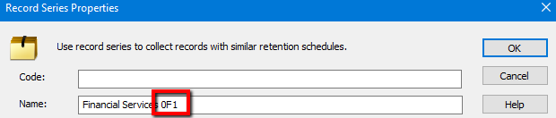

Trying to rename a record series in the Windows Client will bring up the Record Series Properties dialog, where you have the option of removing the code altogether. You could "add" the code to the end of the record series name, but that would just be for show/your reference.
