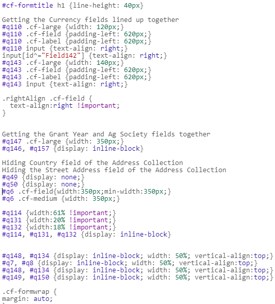

I tried your CSS and could reproduce the same issue. It seems that padding left does not work properly on cf-field when file is saved to repository. It would add padding much larger than configured so the field is pushed to right side out of the view. I will report this as a bug, sorry for the inconvenience.
As a workaround and actually in your CSS, the padding left on cf-field is not needed because it is right aligned. If you remove the #q .cf-label {padding-left: 620px;}, the right align still works and fields could show up.

Rob, I have been struggling with getting right aligning on these fields and have tried every combination that anyone has suggested.  It seemed that some of the CSS would allow right aligning during filling out of the form without retaining that alignment upon hitting submit; and some CSS allowed the right aligning after hitting submit but not before.  I finally get a combination that allows both and now the repository image result has blank fields!  Very frustrating.

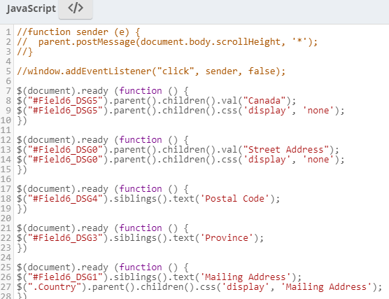

The following is what I have in there right now for CSS and Javascript:
(Field 110 is the Grant Received field) (Field 142 is the Collection field) (Field 143 is the Total Amount Spent field)

Hi Connie,
Thanks for sharing your CSS/JS. Unfortunately I am not able to offer much more insight than, "it's probably due to CSS/formatting". I avoid overriding Forms CSS unless the entire project hinges on it, because attempting to overhaul Forms' layout defaults typically ends badly for me.
On the plus side, it looks like you're very close to accomplishing your goal--if you are able to get it working the way you want, please share your solution!
