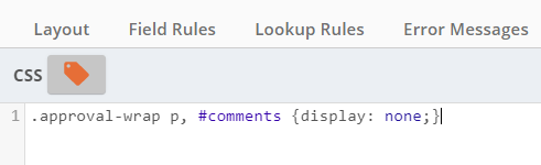

Put this in the CSS entry to hide the comment field
.approval-wrap p, #comments {display: none;}

Where do you enter the CSS string?  The submit button setup in in the process and when I added this string to the CSS on the entire process it did not work.  The submit button and comment does not show up on the form itself as a field, so how do I add this?
replied on January 31, 2020
Put in the CSS block under the CSS and Javascript tab
Thank you.  I did try that, but I have four forms in my process and I think I attached it to the wrong form.  I just tried again and it's working.  Thanks!

For LF 11:
.approval-wrap .comment-section { display: none; }/*Hide comments box*/
For LF 10:
.approval-wrap p, #comments {display: none;} /*Hide comments box*/
