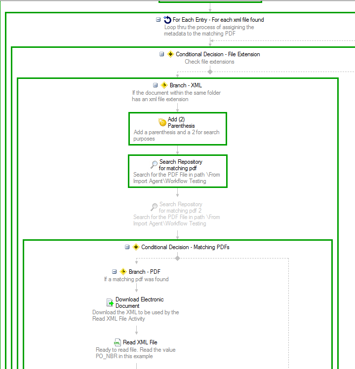

Can you post a shot of your search in the actual workflow?  Let us see what is around your workflow to make sure it is not a different activity causing the issue?
replied on September 15, 2017 • Show version history
Sure. Notice in the branch there is an Add (2) token that I'm using to append a (2) into the original entry name so, this is what we have:
  • One XML in a repository folder with the name abcd
  • One PDF in the same folder with the name abcd (2)
the (2) was added automatically because there cannot be two files with the same name, even if it's a different extension.
When I do the search and simply append the (2) it gives me the result I want.
Now to move forward I want to replace that and simply look for anything that contains abcd, so "abcd*" should return the one with the (2), right? but it does not return anything. I want to get rid of appending the (2) and using the wildcard because there could be a (3) (4) (45), who knows.
