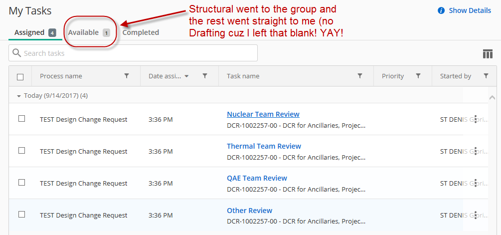

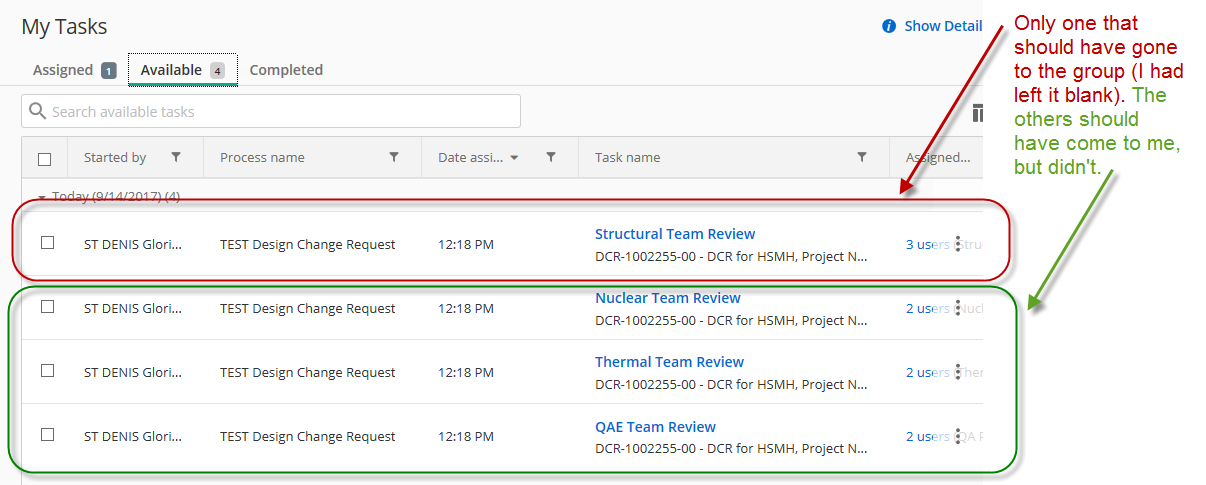

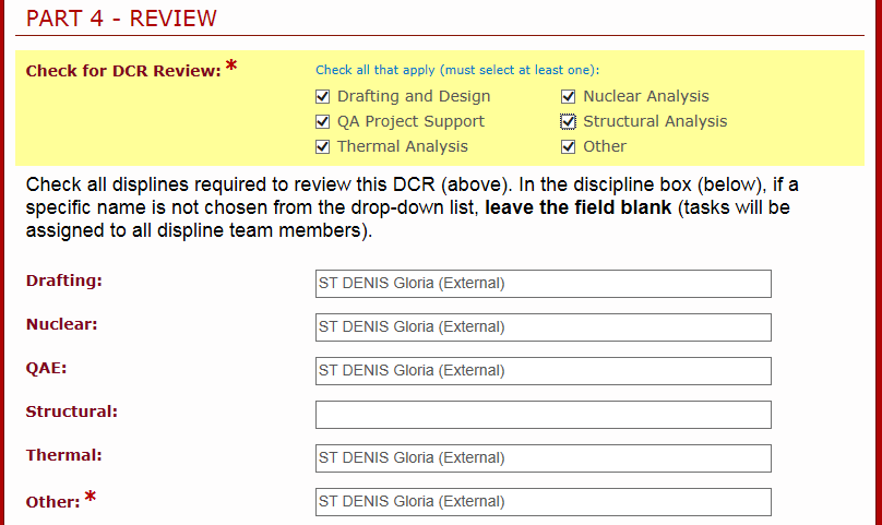

The user filling out the form has the ability to choose a name from a drop-down list or leave it blank (where the task will go to a Team). The issue is that when the user choses an individual, the user task still goes to the Team. How can I override the Team emails and have it go directly to a member of that team?
Everything is working except the email at the user task level. In the example below, all emails should have gone to me but the Structural email should go to the Structural Team.

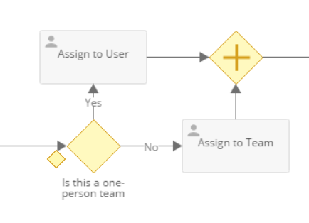

Hi Gloria, I had a similar question and it seems that the most practical solution for us was to have two User Tasks, one with the Team assignment and the other with the individual assignments.
First you would use a Gateway to route the appropriate User Task, where if it's empty it would route to the Team.
Here is the post where Tri Pham assisted us: https://answers.laserfiche.com/questions/126921/Bypassing-the-Assign-to-Me-setting-of-a-User-Task-when-a-team-only-has-1-person#126940

OK, fixed my lookups (my username fields are now getting filled) and changed five user tasks to the first recommended javascript Jason gave me .... and ... drum roll, please ...
It finally worked IN PRACTICE. I can't thank you enough for sticking this out with me. Without you having me look at the variables, I would never have realized my mistake with the new lookups against the new TeamView we created. PHEW! Glad that one is behind me.
