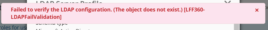

Failed to verify LDAP configuration
asked on September 12, 2017
Has anyone else seen this error or knows how to fix it? I didn't find anything helpful in event viewer. I know that the account used for authentication with LDAP works and exists.
replied on September 12, 2017
Hi Lidija,
The error "The object does not exist" means the "Base distinguished name" is invalid/does not exist. Can you double check that setting?

Yes, I had to go through the entire list (40-some licenses) to find the one that was no longer there and remove it. Is there a better way to fix this in the future?
replied on October 9, 2017
I think we can improve the error message to show which one is invalid. Will that work for you?

Hi, I had to go through the entire list to find the one that was no longer there (or could be a user account that moved to a different OU) and remove it.
