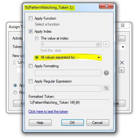

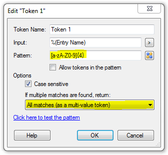

However, if there's too much variation in the characters Quick Fields returns or you just don't want to risk it coming back with something unexpected, you could use the following Pattern with "All matches (as a multi-value token)".
Then, use "modify token" in a separate activity to join each chunk together with a "-"

The second option doesn't look at the separating characters at all, so it will always break it into alphanumeric segments of 4-characters, which you would then join together with hyphens.

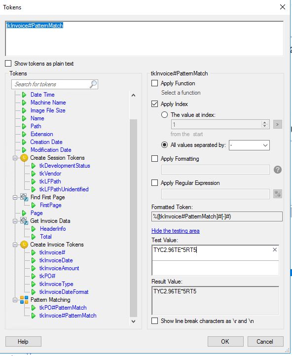

So I went with the second option since it is not always a ".", or a "*". I thought I set up everything correctly but when I do my testing, as you can see in the screen shot, the values are not being seperated. Is there anything I could be missing?
I have my token of tkInvoice#PatternMatch set to "All matches (As a multi-value token)
Thanks!
Modify Token.jpg (69.25 KB)
replied on September 12, 2017 Show version history
You won't be able to test that way. The pattern match splits it, and the token update joins it back together, but they are separate processes so when you put a test value into the token editor it is only testing that portion.
To test the full process, first test the initial value in the pattern matching activity, copy the output, then test that value in the token updater.

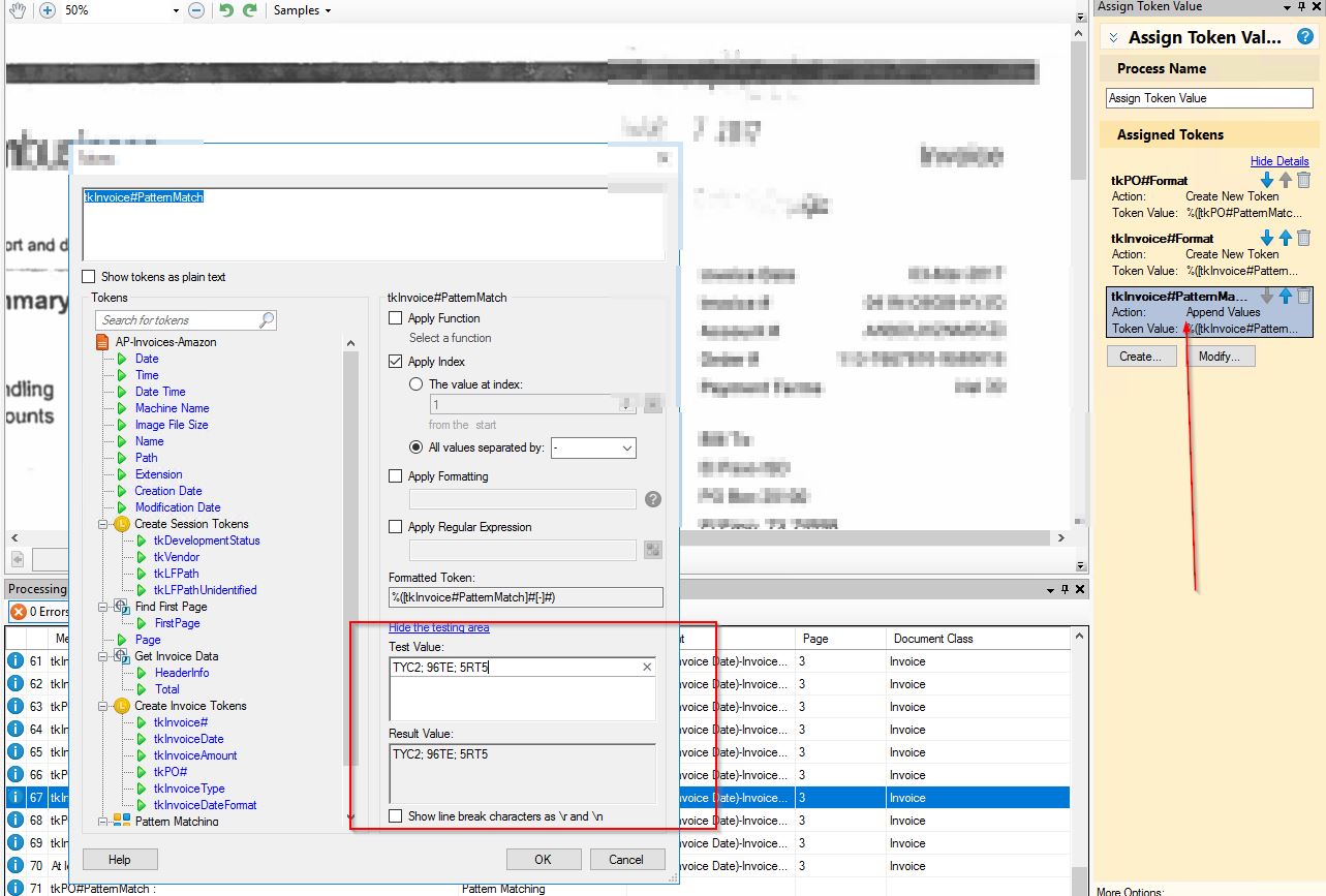

So I have gone ahead and tested the pattern matching process first and that seems to work fine. It seperates the values into something like:
TYC2; 96TE; 5RT5
(I have provided a screen shot of this)

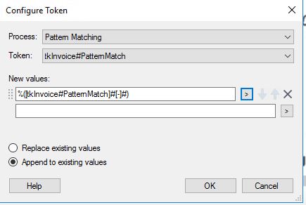

Then what I have done is created another activity after the pattern matching called "Assign Token Value"
(Screen shot of this provided)
In that activity, I have selected modify and updated the information in the first window (screen shot called Configure Token shows what I have added)
I am not sure if this is exactly how it should be set up though as I am not able to test in the token editor of the second activty successfully.
I appreciate all the help so far, I think I almost have it but must be missing something small.
Thanks!
Everything looks good. The problem is not that it isn't working, it's that you can't really pass the true result value of one test activity to another, especially a multi-value.
You could test this more easily in workflow by creating the same activities, just start with a set test value. This really should work the way you have it now, the problem is just how to test it effectively.
