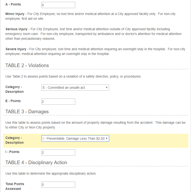

I am trying to insert a formula on my Total Points Assessed field but can not seem to get the formula to work.  Trying to add up the numeric value from single line fields A - Points + E - Points + I - Points = Total Points Assessed.   Any thoughts would be appreciated.  Thanks!

I'm using "Single Line" Fields with a numeric value.  Current formula is =SUM(A___Points , E___Points, I___Points)   The formula returns the number 0.

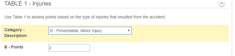

I have another question for you.  Not sure if this can be done with a formula.  When a user fills out TABLE 1 - Injuries they will select from a drop down box A, B, C, D or N/A.
After the user makes a selection I have a field rule that will assign points in a field.  For example, A - Points  0, B - Points 2, C - Points 4, D - Points 8.
The form has two other sections just like the above.  I'm trying to have the formula add up only the points selected.  My current formula adds every field up.  A - Points through J - Points.
Any thoughts?
