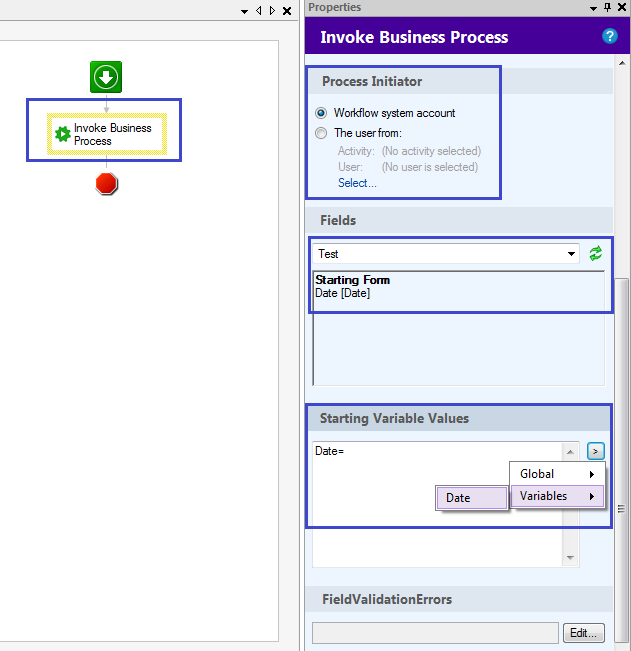

Yes, with Workflow 10.x you can use the "Invoke Business Process" to kick off a Forms process. Once you collect your values in the workflow
  1. Set the user account to be used for the submission under "Process Initiator"
  2. Select the target form and fields under the "Fields" section
  3. Set the values under "Starting Variable Values"

You'll need to store the instance and submission IDs in the repository with your forms. Then you can have a scheduled workflow that runs once a month, finds the documents created during the previous months and uses Read Business Process variables to read data from each form (using the instance and submission IDs to find the corresponding form for each).
