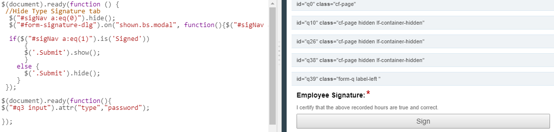

Basically... I hate how the Submit button displays on the first page of my Form, regardless of it has been filled out or not. It's not a huge deal, more of an annoyance, since it doesn't actually do anything. Once you've filled out my first page, it goes away, and comes back again on the final page (4 of 4). What I would like for it to do is go away entirely from the start of the Form until my Signature Box is filled at the end.
I think I'm close... you can ignore the bit about hiding the Signature Box's other option, as well as the password code below that... what I have here is successfully hiding the Submit button from the start, but now, it won't show up at all, even after the Signature box is filled in the end. My guess is that I have the wrong "if > then" statement to work from there. HELP!
