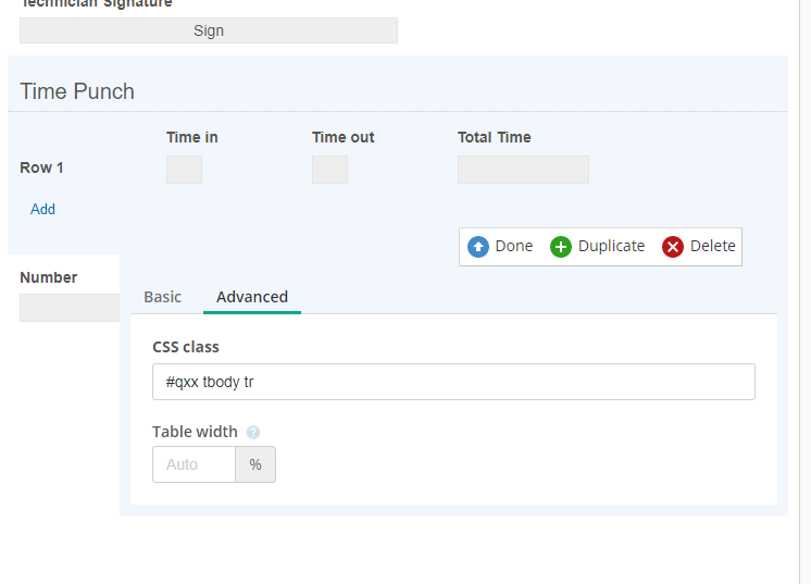

replied on October 1, 2018
so the CSS would be #qxx tbody tr for the table then #qxx for the final external table total?
Hi Jeremiah,
That is correct,
Ziad
unfortunately it did not work
Hi Jeremiah,
To confirm, you have added the timepicker details within the Forms server and they are working as they should correct?
Can you if possible provide a screenshot of the #q within the JavaScript screen? and also the code?
Many thanks
Ziad
replied on October 2, 2018 • Show version history
so this is the code that I am using, the timpicker portion is working just not the calculation

and here is the CSS for the table and the CSS for the external total
CSS Capture.PNG (17.64 KB)

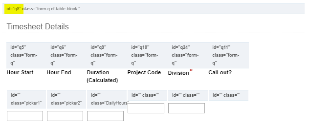

HI Jeremiah,
You are not required to enter any details within the CSS classes for the table.
The qxx was just an example of what needs to be used,
When you are in Javascript screen, just above the table, it details the q(number) required as an example my table is q8 as per below:
 $('.cf-table-block').on('blur', 'input', CalculateTime);
 function CalculateTime() {
   var Time1Total = 0;
   var Shrs = 0;
   var Fhrs = 0;
   var Total1 = 0;
   $('#q8 tbody tr').each(function() { //Targeting table id q8
      var s1 = 0;
    var f1 = 0;
    var t1 = 0;
    var s1 = $(this).find('.picker1 input').val(); //targeting picker1 css class
    var f1 = $(this).find('.picker2 input').val(); //targeting picker2 css class
    // console.log(s1);
    // console.log(f1);
        Shrs += s1;
     Fhrs += f1;  //updating outside variables.
This is in reference to the following on the form:
Hope that gives you a better understanding :)
Let us know how you go?
Thank you
Ziad

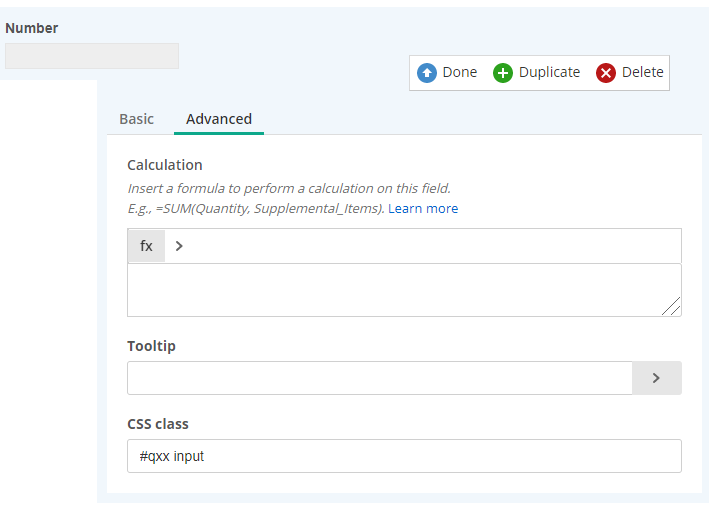

Hi Jeremiah,
Also:
$('#qxx input').val(Total1); //updates external total field
this is for an external field outside of the table to calculate the total. Just make sure to update the #qxx to the related field ID number. I think that this works best in a single line field over a number field, Ziad would be able to confirm.
Kind Regards,
Aaron
