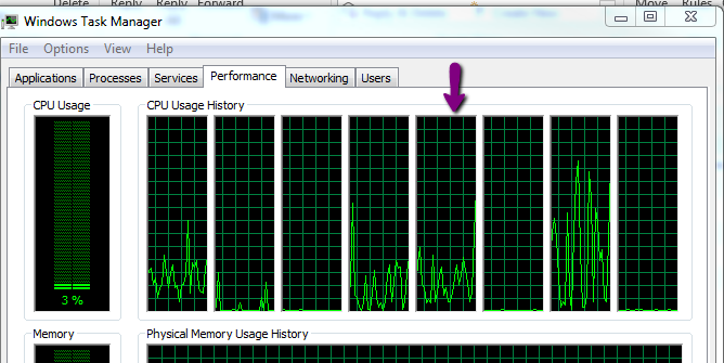

Could you just clarify, you said one CPU, so assume you mean additional threads or cores won't be used either.?
replied on September 1, 2017
For OCR, it's one logical processor. AKA, one of those things you see in Task Manager, regardless of how it's organized in the hardware:
