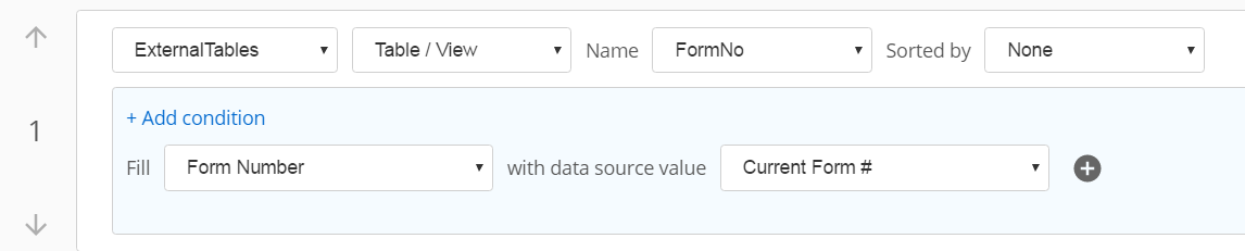

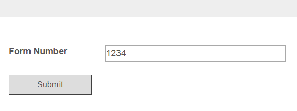

replied on August 31, 2017
Hi Raul,
I'll speak to the method of doing this with Workflow/a database table because its worked well for me in the past and is quick to set up.
Starting with a database table consisting of just one value in a column indicating the current forms number:
I can pass this into the Form using a lookup rule without any condition:
After the Form has submitted, I can use a service task to run a Workflow that will increment the current form number by 1.
This method works well because you can have multiple business process point to the same database table and run the same Workflow, and each form submission will consistently use the most current form number.
