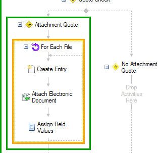

So not quite sure what the issue is but I have a For Each File failing with an error:  The file "filename" can not be found 0453-WF1.  From the screens here, there is clearly a file attached.  Also it is even going down a branch where the condition is checking to make sure there is an attachment in the first place.  So it is detecting that the upload button is not empty.
Condition on branch
Condition on the For Each File.

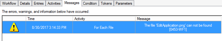

Can you post a screenshot of the actual error/warning message you are seeing in workflow?
replied on August 30, 2017
Sure, here is the error.  This works before but it seems to have stopped at the beginning of the month.  I have re-done the tokens as well.
