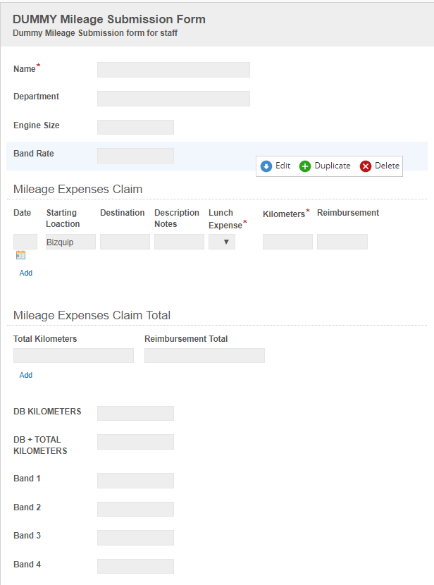

I am working with a table within a form and a database.
The goal is to calculate the expenses for a mileage form.
when name is entered, i have lookup rules in place to populate: department, engine size, band rate, db kilometers, band 1-4.

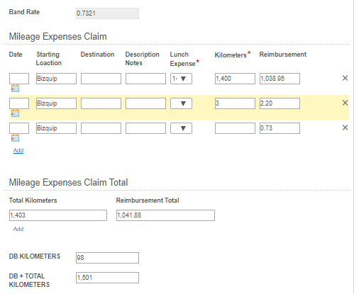

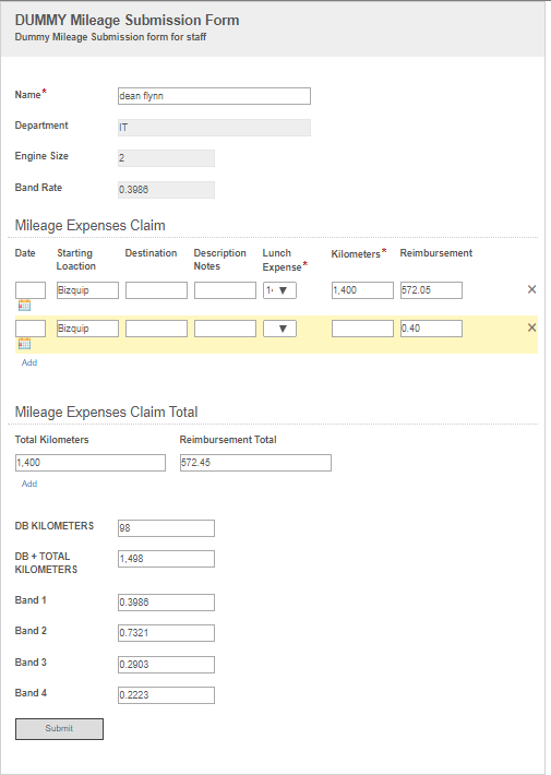

In the preview screenshot, the total kilometers is set to hit over 1500 which will swap the band rate to band 2.
above, the total km has exceeded 1500, the band rate has switched, but it has updated the rows which were already calculated. I need the first 1500 kilometers to be calculated at 0.3986 and then above 1500 to be calculated at 0.7321 and then added together in reimbursement.
This is my attempted IF statement within reimbursement to calculated each row.
Hope this is enough information provided!
