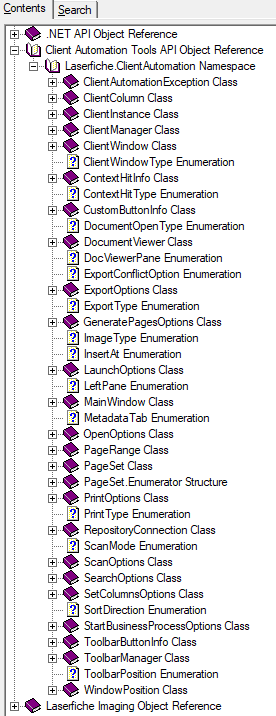

The Image Enable library has been degraded and replaced by the .NET Client Automation Tools (CAT) library.  To view the documentation for CAT, open the Laserfiche SDK 10.2 Documentation
The current Image Enable replacement library is now called Client Automation Tools (CAT).
