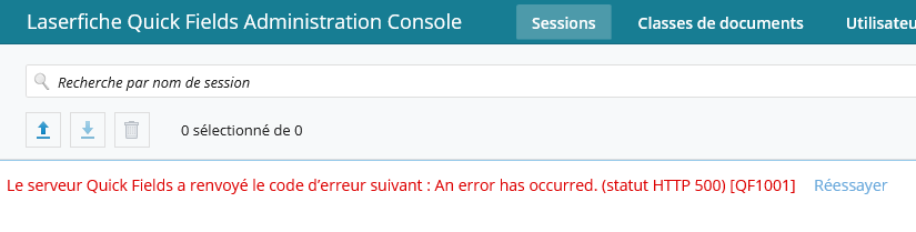

I'm trying to use Laserfiche Quick Fields Administration Console but I have the error below :
"An error has occurred. (statut HTTP 500) [QF1001]"
On Windows events, the Message is : "The database connection information is invalid".

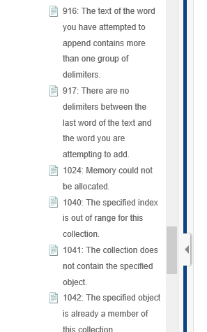

In Laserfiche Administration Guide, under "Error Code Listing", I dont have the error QF1001

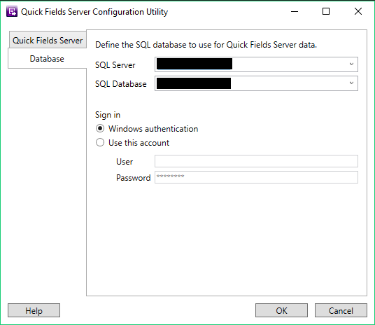

Have you use the Quick Field Configuration Utility to configure the SQL database connection for your Quick Fields server, as listed in the post installation procedure help files?
replied on August 29, 2017
Hi Brianna,
You right, I forgot to configure my connection.
I don't have this error anymore.
