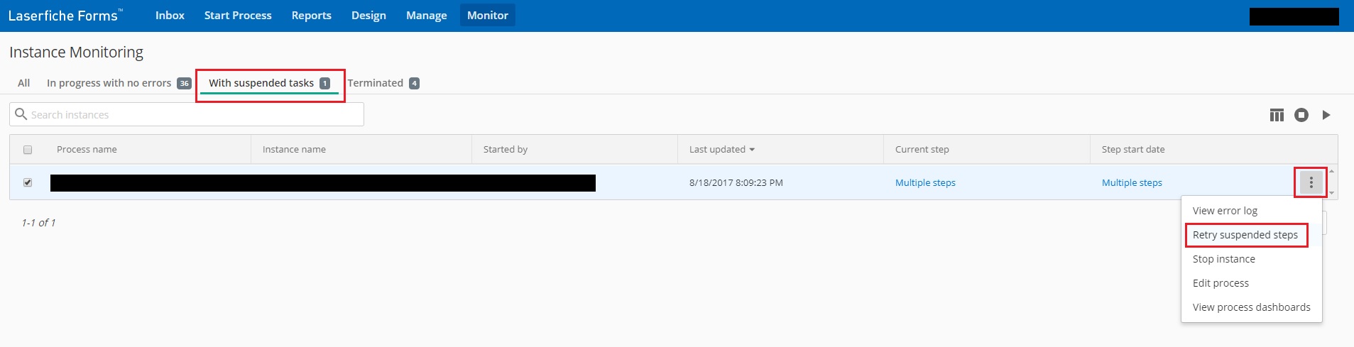

Just to confirm, when you go into the Monitoring page and click the ellipsis menu on the right of the instance that is suspended, you don't have a "Retry Suspended Tasks" option?
replied on August 25, 2017
That's right.

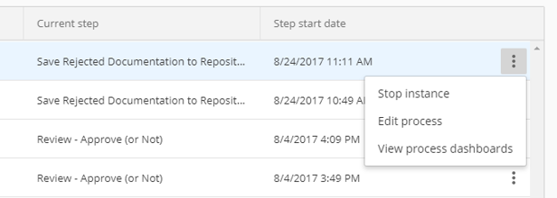

What happens when you open up the instance and check the ellipsis menu next to the process step that has the "Suspended" icon next to it?
replied on August 25, 2017 • Show version history
There is nothing there.  There is no ellipsis on the far right at all on those two and there is nothing that I can open anywhere else either in that spot.  I tried clicking on everything on that line.
Does it actually show up as "Suspended" with the little pause icon, or does it just show that as the current step?
Actually, Jason, it doesn't say "suspended" there on these two.  It says "in progress" in the same spot where suspended usually is.
