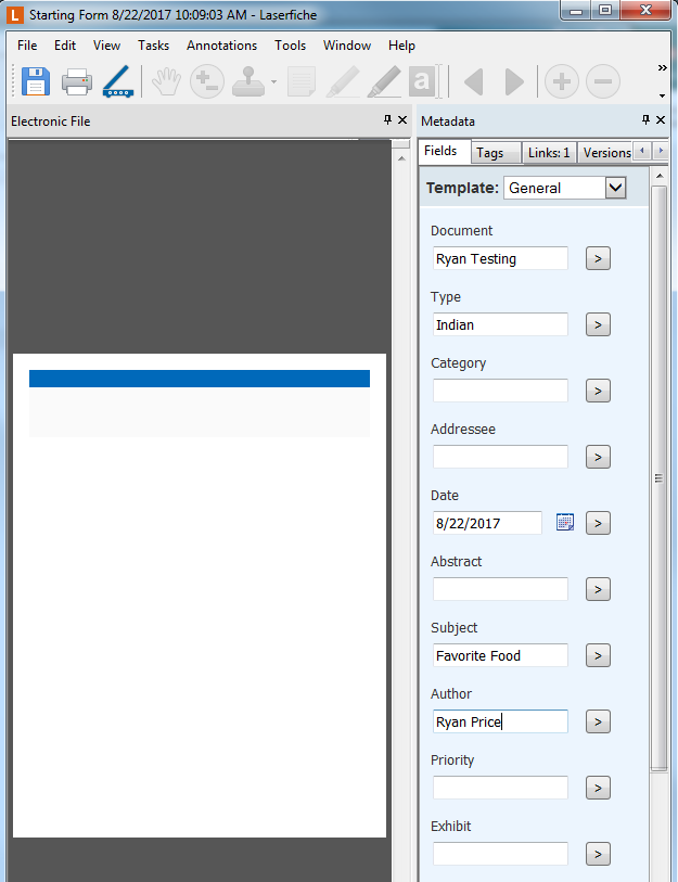

I have set up a basic process with a Save to respository task
-Save the submitted form from this process step ( the form name )
-Save as PDF
When I submit the form, the PDF is created in the defined repository location, but the electronic file preview doesn't capture anything, see attached image.
maybe I missed something on the DMZ forms server install ?

O geez.. I clicked "Download" of the form after submission and I see the error now.
The Forms database is from a later version than the current Forms product. To resolve this issue, please contact your Laserfiche administrator.
Which happens to be me :)   so I 'll try to fix that now and see how it goes

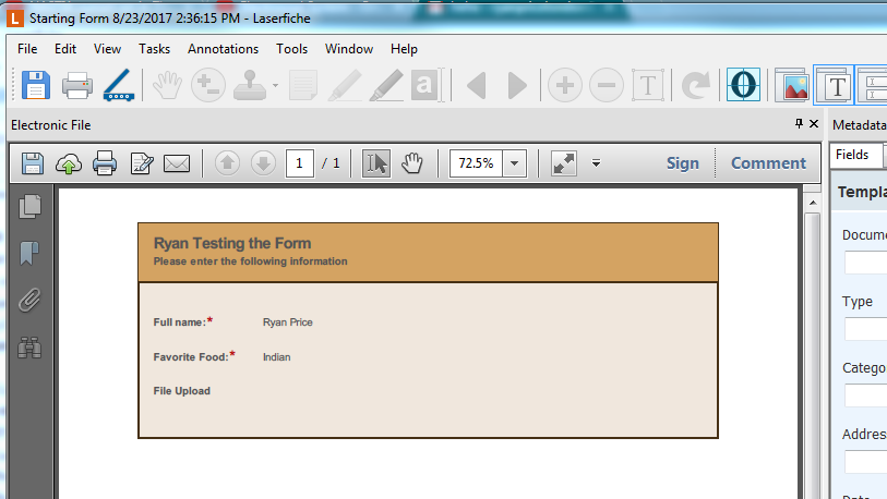

replied on August 23, 2017
I did a full removal of forms on the internal forms server. then a full reinstall. configured the DB settings.. it showed there was "already a DB, would you like to register", saved the settings
and tested from the DMZ forms and am now able to capture the completed form.
