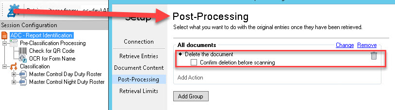

Do you have the session set up to delete the original document from the repository?  Do you have the session set up to create new documents or merge documents?  If you are deleting the source document all together and creating new documents for each document class, this should take care of issue #2.

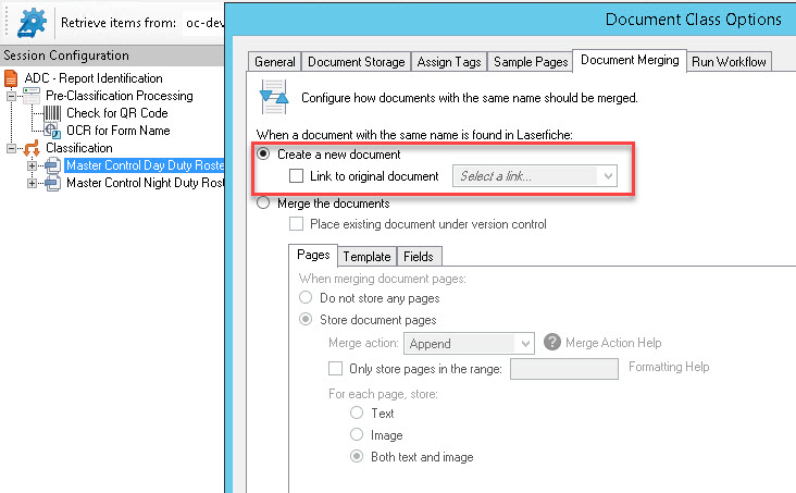

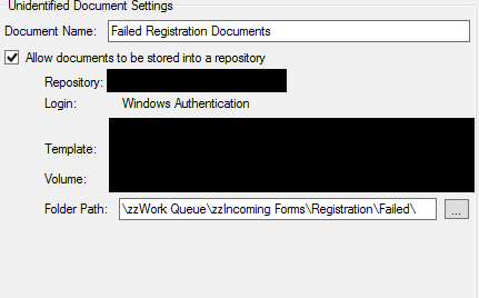

Can you share a couple of screenshots of how your OCR sessions are set up and how your document classes are set up?
replied on August 18, 2017
Done...
