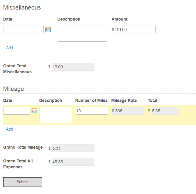

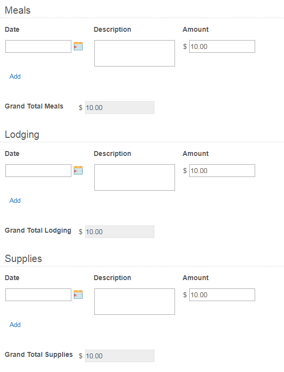

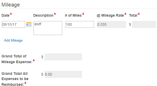

I have some tables created that adds up the total and they automatically add up to a Grand Total Currency field. I then have a Mileage table that I found out I would need JavaScript to make it work. After putting in the JavaScript and getting everything to work it seems like my Grand Total section doesn't recognize the Grand Total of the Mileage. Does this mean I have to write JavaScript for everything to be able to add?

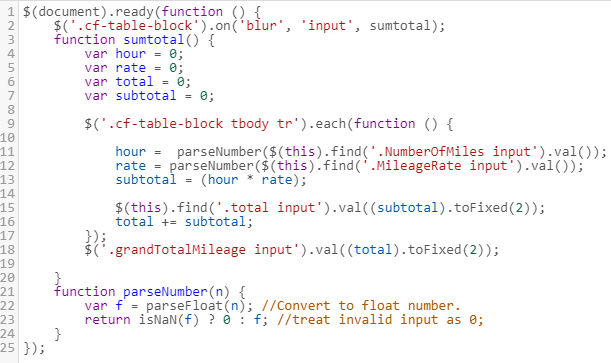

So my Grand total at the bottom adds up the Grand Total All Expenses to be Reimbursed, but it doesn't seem to read the Grand Total of Mileage Expenses. I did use JavaScript to get the # or Miles * Mileage Rate to fill the Total column as well. (Code is on the bottom). It has been a while since I've done any coding, so I am rusty on some of my knowledge. Thank You.

I'm a bit late to the party here, but I'm lost as to why the forms calculations aren't working for you.
Assuming you have all of your field types set correctly (using number fields and currency fields), I was able to replicate your set up and get it working correctly.
For the Mileage Total Field, I used the formula:  =PRODUCT(INDEX(Mileage.Number_of_Miles,ROW()),Index(Mileage.Mileage_Rate,Row()))
(My variable names may be slightly different than yours, but should be close)
replied on August 16, 2017
I tried yours too and it worked, but it looks like the total has a default value right away even if my number of Miles is blank it's showing that the total is 0.54 because the Mileage rate is pre-filled in. Not sure if you're getting that as well?
replied on August 16, 2017 Show version history
You're right, I see that as well.  With the currency field only allowing two decimal spots, it rounds.  If you do 1 mile, it stays at 0.54, but 0.99 miles rounds down to 0.53 as it should.
You might be able to play with some IF formulas to get it to show up blank.  From my experience however, people haven't had any issues with the default of 0.54 showing.  Making the Number of Miles Required ensures that the value changes.
Nice I'll play around with some IF formulas to see if I can get it working. The only reason I would want it at 0 is because I have it where the mileage section will only show if they checked the mileage check box, but with it not being at 0 my Grand Total Expense is still shows the 0.54. But thanks for the information I'll play around with it more to see what I can do.

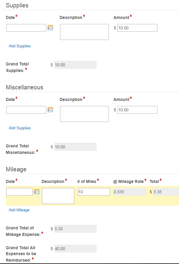

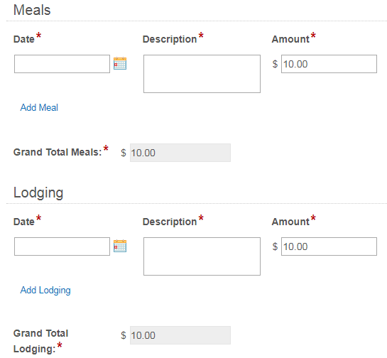

I noticed if I copy and paste the first form and add a second form which is identical, the Total field is blank unless I go back into my # of Miles field and click in it, and then tab/click out of it then it repopulates. Is there a way to keep it from disappearing?
First Form shows this:
But when I get on the Second form it shows this:
I feel like it's just another JavaScript code that I have to put into the 2nd form?

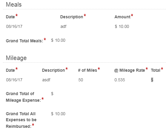

Correct, user submits Form 1, and then a reviewer approves/rejects Form 2. I did a test form, and after submitting Form 1 even though the submitter sees that all the information is there, after submission Form 1 itself isn't holding any of the data. Looks like it's saving the other sections that didn't use JavaScript. Would this be due to JavaScript "saving" differently? This is all on the Form 1 after submission.

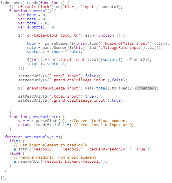

Can you post the revised/updated code from Form 1?
Here is the revised JavaScript code from Form 1
Okay, the problem you're having here is that you're disabling the "read only" state of the ".total input" after you already set the value.
The read only changes for that field should go before and after where you set the value for that field, not with the other field. Also, you need to add the .change to the end of that one as well.
