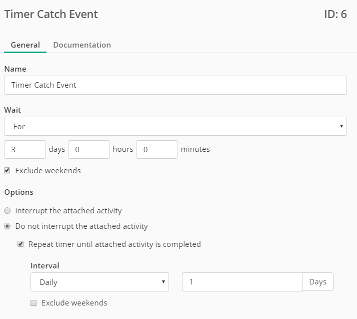

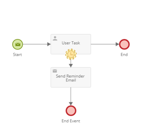

I would keep the timer on "do not interrupt" so that it doesn't re-send the user task, but attach it to an email task that does not loop. Instead of the loop, you can use the built in "Repeat timer until attached activity is completed" option so you can keep sending people reminders until they finish.
Here's an example in a simplified process:
The reminder email becomes its own branch, so each time the timer runs out, a new email will be sent instead of sending multiple. In my timer properties, I've set the example information so this email will first send 3 days after the task is assigned, and then once every day.

replied on August 16, 2017
Great!!  Thank you this worked for me.
