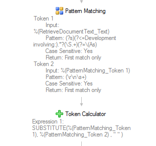

replied on August 14, 2017
Something like this should do it:
Pattern Matching does not do substitutions, so you need a second activity for that.
Your patterns gets the text out as:
"Construct Magic house with 34 car attached garage, covered deck,
            covered walkway, covered porch, and driveway with front and rear setback
            relaxations —Total site coverage 48.3%"
The second pattern finds the leading spaces and uses that value in the Token Calculator activity to replace it with a single space. The final result is "Construct Magic house with 34 car attached garage, covered deck, covered walkway, covered porch, and driveway with front and rear setback relaxations —Total site coverage 48.3%".
If you have a variable number of leading spaces from line to line, this might not come out as cleanly.
Thanks Miruna. I hadn't considered breaking it into multiple steps to get the result. Your solution worked great!
