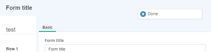

Could be many things, but one thing that I found one time to work for me is this. Open the form from within LF Forms and then just open the title of the form and click "Done". Then try the form in the browser. See screenshot below.
Again, could be many things, but I found out that this worked for me. It usually can be if the Form Title has some type of HTML tag.
