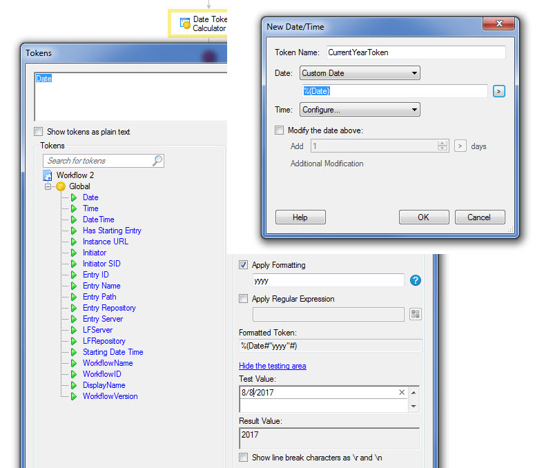

Can you just put a Date Token Calculator activity at the beginning of your workflow?  Use the current date and format it to pull just the year.  Then use the token in your query in place of "THISYEAR".  Something like ... {[]:[Document Date]="*%(CurrentYearToken)" ... where the token is what you created earlier in the workflow.

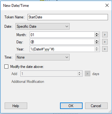

In addition to Jennifer's solution, you might try a date token calculator like this.

({[]:[Document #]~="'E-*'"} & {[]:[Document Date]="*%(CurrentYearToken)"} & {LF:Name="*", Type="D"}) & {LF:LOOKIN="\01 Business Record"}
({[]:[Document #]~="'E-*'"} & {[]:[Document Date]>="%(StartDate)"} & {LF:Name="*", Type="D"}) & {LF:LOOKIN="\01 Business Record"}

Are you putting in a full date or just the 4 digit year? It should be in the format of 01/01/2017. That is the reasoning for using the date calculator.

OK, the Start Date token DID work! I was testing incorrectly. As John suggested, I was not testing properly. When asked for test input, I keyed in just the year and should have keyed in 01/01/2017. The year token will be helpful elsewhere in my logic, so thanks everyone for the input!!!
