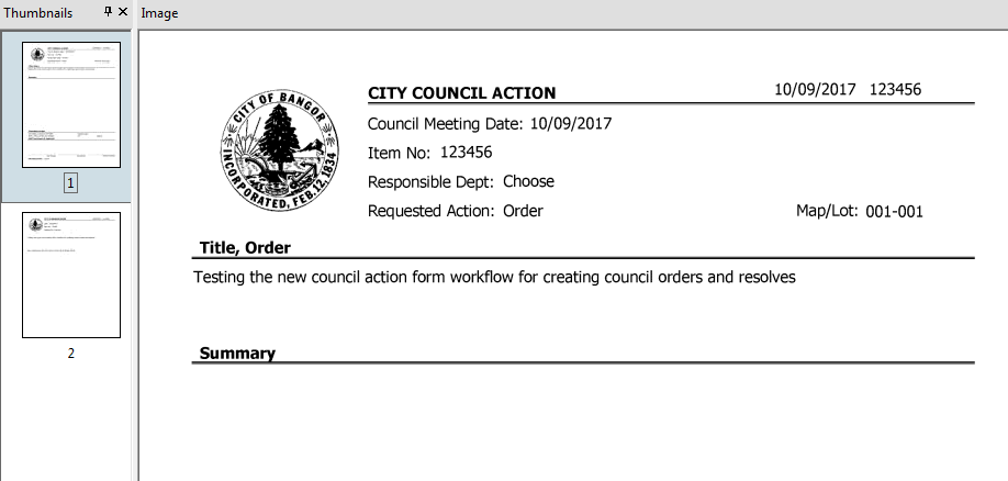

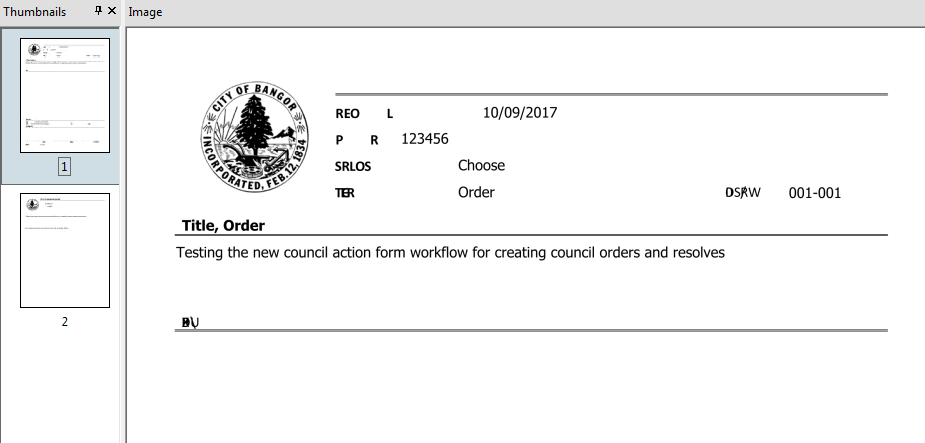

I want to generate Laserfiche pages for PDF files.  In my options, I checked the box to 'Generate Laserfiche pages' when importing PDFs.  Theoretically, this should save me a step so that all I have to do is delete the electronic file when the PDF is uploaded into Laserfiche.  However, after deleting the electronic file, the resulting text on the PDF is garbled.  See screenshot:
However, if, instead, I generate pages again (because the pages are already generated on import) by going to Tasks > Generate Pages the results are as I would expect them to be, minus the garbled text:
I took this one step further and unchecked the option to automatically generate pages on PDF import, imported the same PDF, generated pages and the results aren't garbled.
The engines for generating pages automatically on import and generating pages manually from within the client appear to be different, with the automatic process inferior to the manual process.

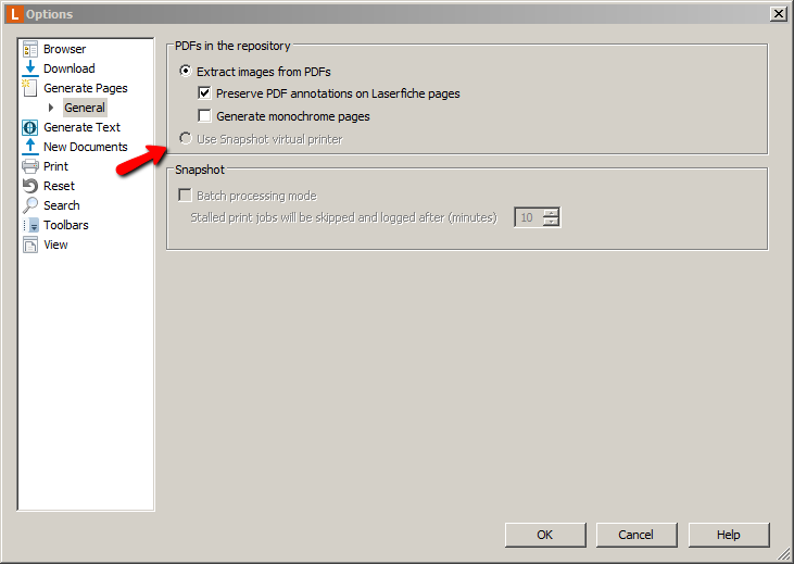

  1. In the options page, check if you have it configured to use Snapshot for generating pdfs on existing documents:
  2. If you are using the 10.1 client, try updating to 10.1 Update 1 to fix the scrambled images issue.
replied on August 16, 2017
Thank you Robert - it is configured to use Snapshot so I will try the update to see if it will fix the issue.
