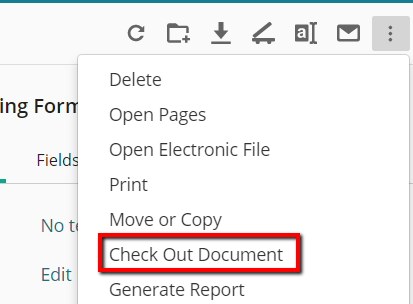

Hi Mitch,
You can still manually check-out documents by going to the overflow menu on the toolbar:
