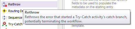

Can you use the Rethrow activity?  The description of the rethrow sounds like what you are asking for.
replied on August 2, 2017
Hi Jennifer,
I tried it, just terminates the workflow. I thought the same at first.
