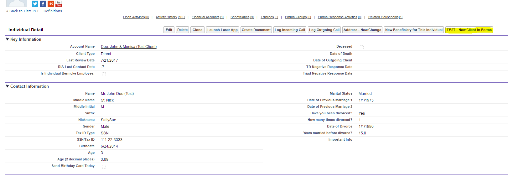

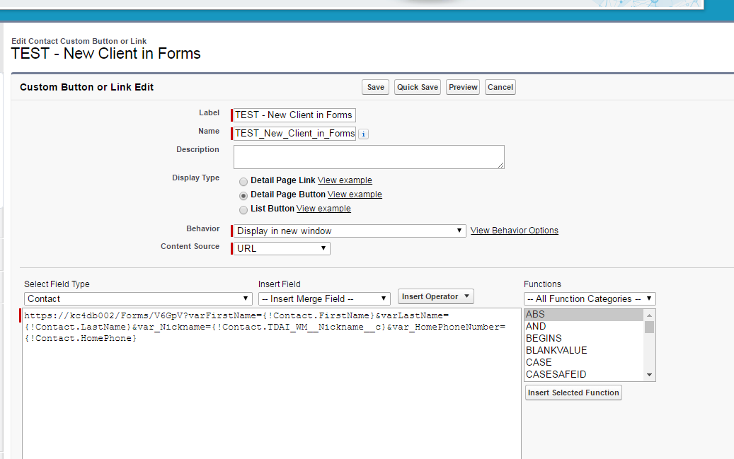

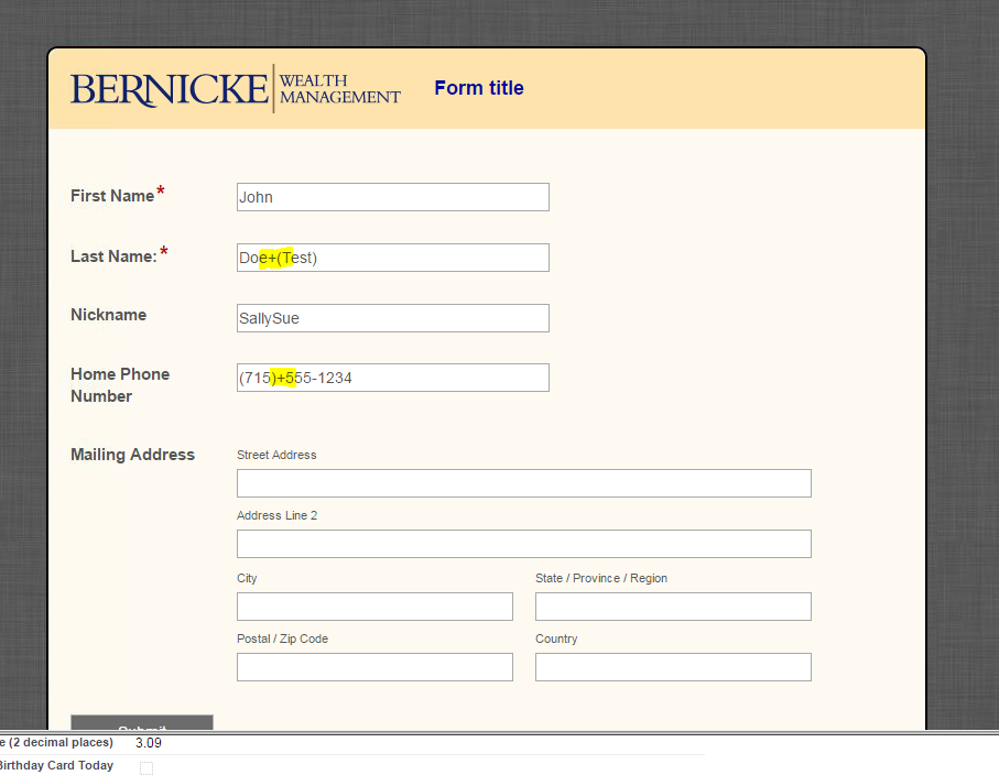

Here is an example of the URL and the "+"s being added.
And the Button/Link itself -

As far as the "+" where spaces should be, my best guess is that the functions are putting something in the URL that Forms is interpreting as the "+" character. What do the values actually look like in the address bar (the actual URL it is creating).

The fields themselves are spaces, and when referenced in the URL, there are "+"  signs.

Okay... so these plus signs... any ideas as to how to get rid of them?
replied on July 28, 2017
The URL should have a "%20" for spaces, not "+", so it sounds like you'll need to address that where it builds the URL.
If you're seeing the + sign in the actual URL in the address bar, then the functions in the custom button/link builder might be injecting the + for some reason.
Since it uses functions, you could try adding a Substitute function wrapped around the variable retrieval that replaces " " or "+" with "%20" and see what happens.
The URL parameter should look like more like "?varLastName=Doe%20(Test)"

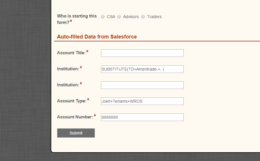

Was already working on a similar fix, only using SUBSTITUTE in laserfiche forms...
With forms however, it was blank, and with the URL, this happened...
I just tried having two field... one that gets assigned with the url on the first page, and then another field/variable on the next form/page that had the SUBSTITUTE formula using the first field... and that didn't work either. :/
