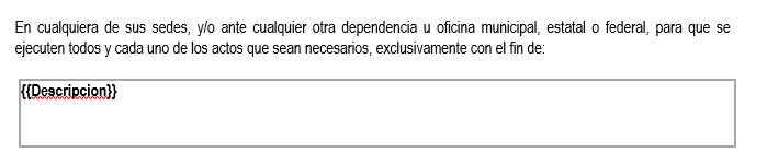

Wait
The {{descripcion}} now goes without the correct format. The replace its for example "description" (this is what i want) and de merge is "description" and with other type of letter.
replied on July 26, 2017
If you mean it's no longer bolded, then that's Word formatting and has nothing to do with Workflow. Make sure you still have it formatted as bold in the Word template you use in Workflow.

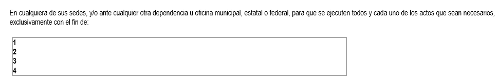

results in
I didn't change a thing but now seems to work fine.
