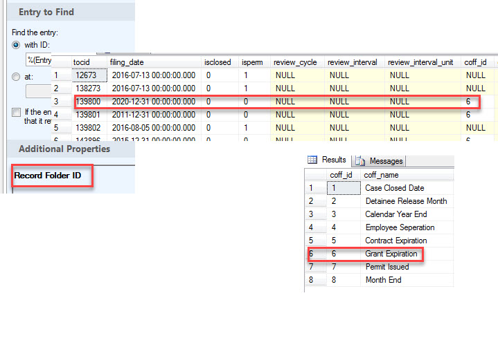

Are you using the script just to find the information?  Or does the script also create the destruction certificate?
Can you use a Data Query to pull the information first and pass it to the script?  Find the entry you are working with and returned the Record Folder ID as a property.  Use the Record Folder ID to query the record_folder table matching where tocid equals the record folder ID that was returned.  Grab the coff_id field from that look up.  Use the coff_id to do a look up on the coff table where the coff_id returned in the previous query equals coff_id.  That will give you the ability to grab the coff_name as a token and pass it to the script or whatever activity you are using to create the certificate.
