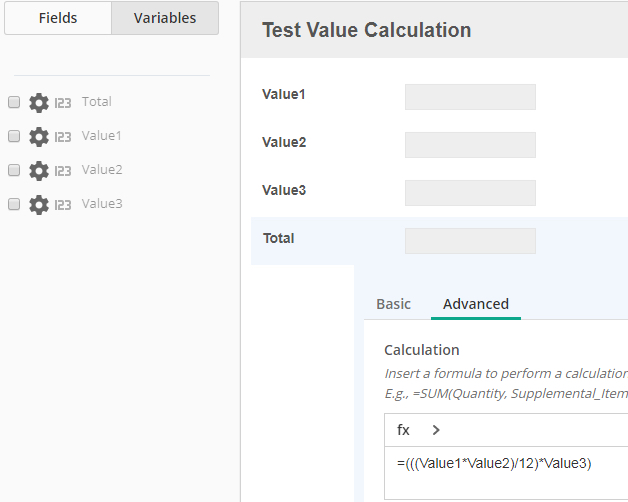

Hi Zane,
I've duplicated your setup with four Number fields as shown below, no changes to the default settings other than to add your formula into the "Total" field's calculation and it works fine.  So your calculation is correct, maybe it's a field setting issue?
If you can't find the issue, maybe cut your calculation back to =(Value1*Value2) and test that, then add the remainder incrementally to identify where the issue is occurring?
