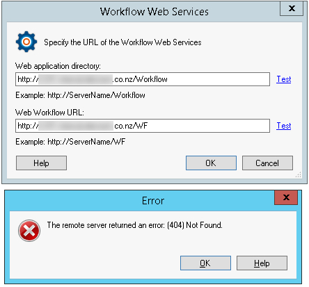

If we try testing the Workflow Web Service URL's in the Workflow Administration Console, we get the following error:

Do you get the same 404 error if you open a web browser from the Workflow server machine and go to http://localhost/workflow or http://yourwfserver.co.nz/workflow?
What if you try just http://localhost or http://yourwfserver.co.nz? Are you able to access the default web site and see the IIS logo page or do you also get a 404 error?
If you get a 404 error just trying to access the site itself, then that may be something the customer's web administrator needs to look into. Perhaps check if the site is even running at all or if perhaps port bindings were altered.

Thanks very much for your response Alex, it looks as though the port bindings have been changed.  I'll let the customer's IT team know.
