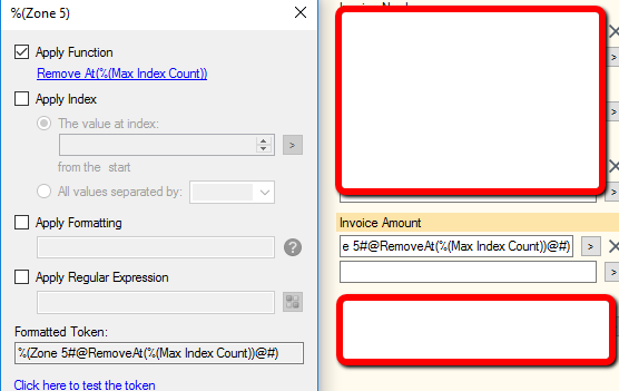

I'm working with a document that has a column of values that I'm trying to extract using Zone OCR.  This column can contain anywhere from 1 to 20 values. These values are a list of invoice amounts followed by a grand total as the last value in the column.  The Zone OCR region has been configured to read multiple lines and create a multivalue token from the results.
Currently Quick Fields is storing all values, including the "grand total", in the multivalue field I created.  I'd like to remove this grand total from the list of values.
I've tried using the "Remove" function at a token value that's reading the final value in pre-processing.  Although I've confirmed the token value is correct, the remove function doesn't seem to catch that the token matches a value in the list.
I've also tried using the "Remove At" function and providing the index of the number of values using tokens, also with no success.
Please let me know if I'm missing something obvious or if there's another way to go about this.

Yo Alan!
Yeah I tried the "Remove At" function.

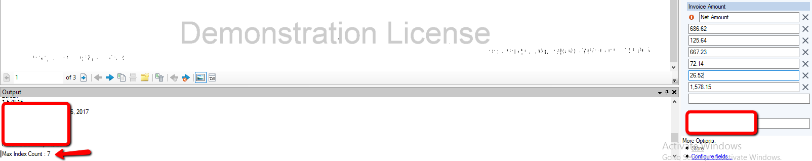

I think the issue regarding why the "Remove At" function isn't working is because I'm feeding the function a token rather than a static value.  As you can see in the Invoice Amount field, there's a field with value "Net Amount".  I confirmed that I can use "Remove At" index 1 to remove that field, and also confirmed that I can use "Remove At" 7 to remove the total, but keep in mind, although the screenshots show the max index at 7, not all documents will have the same amount of line items, and will change the max index.
Are there other options you can think of that I might be missing?

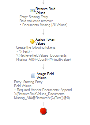

replied on July 26, 2017 • Show version history
In your screenshot you're using a token for the remove at function which should work the same as if you plugged in a static number in there. I tested this in workflow (with random fields that were multi-valued) mainly because it was easier to create fake data for. This is what I got:
This worked for me in workflow where it always removed the last item in the multi-value field. You should have the same function is Quick Fields as well.
If you want, you can send over the QF session with a sample document to the presales inbox and I can take a deeper dive into your session.

We actually were required to sign an NDA to receive the samples, so I don't think I can send over the exact documents I'm working with but I do appreciate the offer.  It should be easy enough to create some samples for QF; just create 2 word docs, create a dummy list of variable length on each, import to LF and generate pages.
I have no doubts that WF is able to accomplish this, but all the evidence I've found is pointing to the fact that the "Remove At" function is unable to resolve the token I'm feeding it.  For example, as I mentioned, if I type 7 into the "Remove At" function, it will remove the 7th value.  If I use Assign Token Value and create a token with a static value of 7 (or any other value, for that matter) and then use the token in the "Remove At" function, nothing happens.
