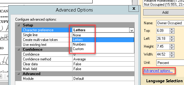

Have you taken off the color removal?  Since the numbers are red color removal might be making them too light to read.  I also have issues with getting a good quality OCR in quick fields.
Have you thought about trying 2 OCR zones in the exact same area?  One would have a character preference set to Letters and look for the words so you can check orientation.  The second would have a character preference set to Numbers.  After the numbers maybe do pattern matching to look for the number of digits in a row instead of just stripping out the letters and spaces?

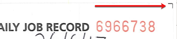

My first guess would be that the Zone OCR process is actually returning text from a different location than the one you're expecting. Do you get the same result (i.e. just a "7") if you OCR the whole page in Quick Fields instead of just a zone? Do you have any deskew, resize, or border removal processes in your session? What is the 'Use Existing Text' advanced option set to for your Zone OCR process?
replied on July 19, 2017
Hi Tessa,
I have just tested with whole page OCR and found the 7 on the example document I described:
I've got Single Line set as True in the Advanced options for the zone OCR settings so I'll revisit that and see if I can get that one sorted without breaking anything else.  :o)
Ah, I see. If you have Single Line set to true and it's reading that little corner as a 7, then that explains why it's not getting anything else. If I were you I'd just try moving the Zone down a little bit.
